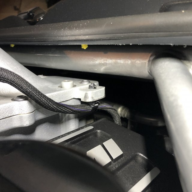

So you can't run the spacers and shock brace together?
My understanding is that you can NOT use the FI spacers (10mm / 3/8" thick) AND have a typical tower brace. But I do not know this first hand, I believe it was @Old Mopar Guy that stated he didn't think there was room based on his installation??

The thicker FI plates wont work, it seems, with the PG brace. These don't appear as thick, but still may interfere with the brace. Theres not much room at all between the sc and the brace, and the factory black bar above the brace.
Doesn't look like much room at all. Time for a 2x4 cheater bar. Mess up that pretty blue bar.
The Thermalnator gaskets are approximately 1/8" thick... leaving plenty of room :)
I just looked at mine and it has plenty of room. My brace is a Speedlogix. It looks further back than yours and looks to have an inch clearance between the top of the bolt and cross bar. But, it will have to come off to install the spacers.
It might depend on what brace ?... but my Speedlogix 4 point strut tower brace fits with FI spacers still with 1/2" gap & even racing it & engine torqueing over it doesn't hit the brace.
