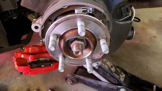

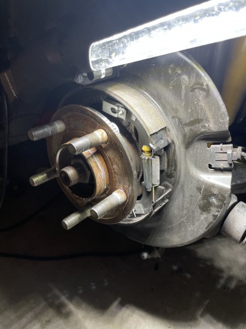

As @BULL said, maybe a pebble or rock. Cleaned out the isolator cups had a ton of rocks in there. Inspected e drum, nothing looks out of the ordinary.

Sorry guy, that axle face is HORRIBLE...
Scotch-brite on a disc...
Or a variety of other similar things...
Not saying it's the problem, but they need some maintenance love...

Thread Starter #30
things that are not on the list of worries… that.
went for a ride, went to the local school lot and did figure 8s. Couldnt get it to happen
going to drain diff and inspect for particulate
Bull Shit's could be brite and true.
17,371
54,368
Ok, let me rephrase.
"Not saying it's the problem, but its not helping you isolate the issue either."
