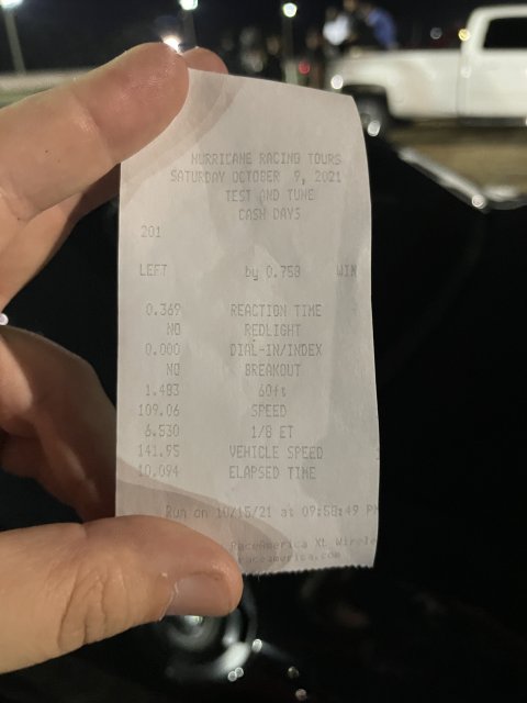

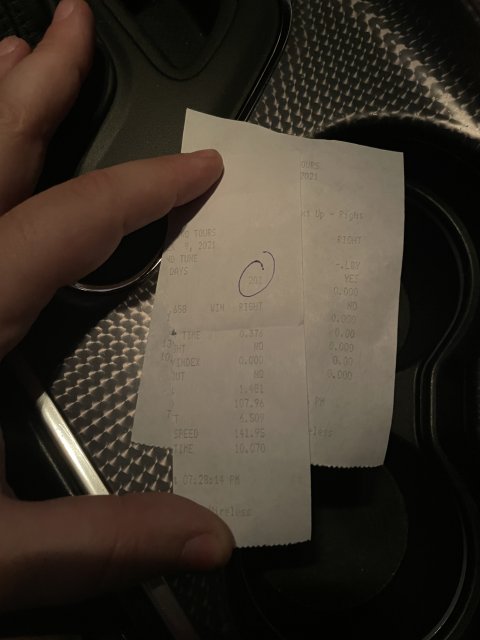

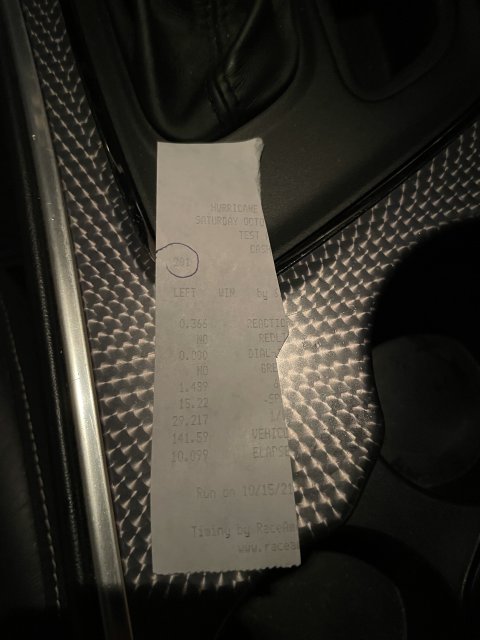

Had her diales in for 10.0 bracket racing. Felt comfortable tuning the transmission finally.
C100C298-70DE-4794-B108-6ABF63D82FFC.jpeg 7F2FB500-3D23-4F83-9E0C-5308F2655928.jpeg 16F70697-9E8F-45C6-95A0-7777A6D421B5.jpeg
Then when making a hard left turn clinking and clanking. Thank God I had a friend with me and we pulled over into the lot nearby. Then we tested the car moving forward Straight and there wasn’t an issue, then we tested while turning and that’s when the clinking clanking woukd occur. Did the speed limit all the way home and she sits in the garage. Went out with the poppers in the ram and got tacos and I have coronas waiting for me in the fridge, just sucks this had to happen right before the event, Speaking of anyone got any axles for sale?

your mph is pretty strong. Pretty consistent passes.
Looks like fun!
