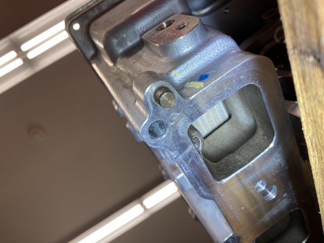

Anyone have torque specs for the supercharger cooling brick screws inside the blower case? I need to disassemble the unit for shipping to SDG and the bricks and rear manifold come off. Manifold not a huge deal but figure those brick bolts are ones you don't want coming loose and getting ingested. If not I'll just have to go by feel when removing them, and maybe a drop of blue loctite when they go back on? Figure to use some petroleum jelly on the coolant brick o-rings @16GoManGoHC2 what do you think?
Sounds like the front drive on newer superchargers no longer uses a paper gasket but has been replaced with anaerobic gasket maker. That was new for me so I'll have to pick that up for re-assembly.
Also, anyone got the Metco tools laying around and wanna get rid of them? I'll need the HPT2000, HPT1000 hex adapter, and the HPT2001 Demon/RE pin adapter as well.
I just tighten them by feel for bolt size. If you want to find a true torque spec just look up the torque spec for the thread size in a button head and use that. But yes I use blue Loctite on them they don’t have to be overly tight but yes you don’t want them to come loose either lol.
The anaerobic sealer that I use is this Loctite stuff works great doesn’t Hardin until made it and you wipe off the excess that squeezes out and it makes it perfect seal.

@fumanchu182 these are the little screws I'm talking about. Ironically when searching pictures I found this one that you actually posted a while back.

Got the blower disassembled. I think I found what happened to it. These Litens pulleys are supposed to be decoulper, so when you lock the shaft it shouldn't spin clockwise, but SHOULD spin counter clock wise. That's how the decoupler works AFAIK. This one was locked up. Wouldn't back spin. I go to remove the pulley, flip the snout over and the 15mm shaft bolt head literally falls off. It had snapped and this was before I even touched it. My "guess" is that the decoupler or something went bad and somehow caused that bolt to break?
Getting that pulley off was MUCH harder than on my Hellcat. I have a big boy impact, Nitrocat 1150 which as 1295ft/lbs breakaway torque. It wouldn't budge it! I put a heat gun on the front of the pulley for 30 seconds or so and brought it up to 150° F and hit it again and it broke free. Crazy it was that tight. No loctite on threads. That had to be over torqued?
I'll get everything cleaned up tomorrow and off to SDG Motorsports for the rebuild. While it's gone I'll take the time to clean the intercooler bricks, lid, etc. They have a lot of oil residue on them. Not sure if something else was going on, or just no catch can or what.
