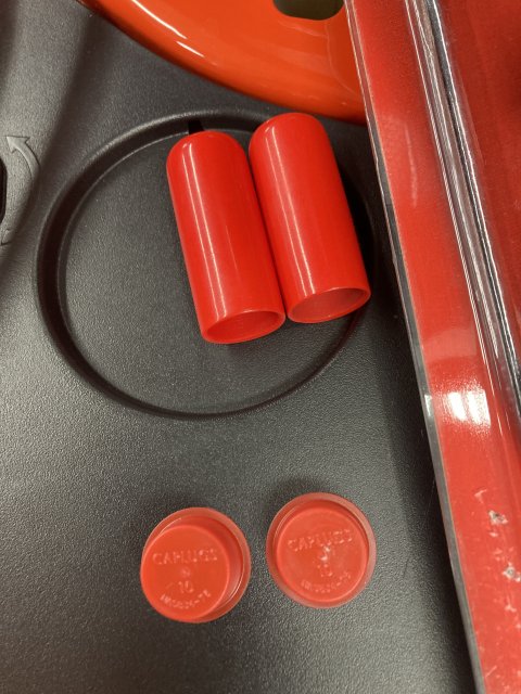

O, I forgot to post the pictures along with my post lol
These plugs and capacity cost about $for all of them lol. The caps go on the SC manifold fittings and any barbs, the plugs go into the hoses.
