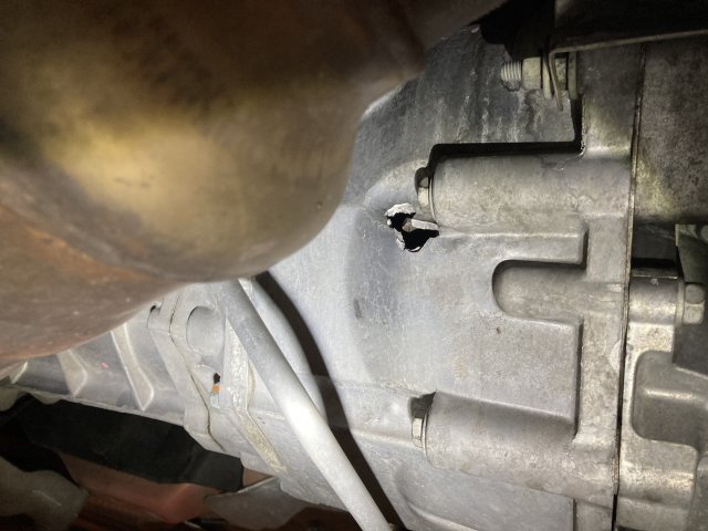

Yea, shoveling snow every other day drove me lu lu and I cracked LOL. No, actually upgrading pistons and rods was a winter project dreamed of for this year but time and energy not there BUT my boy after being back in college classes just one week came home sick, tested positive for COVID so I’ve been hiding in the garage as much as possible and yes, got bored and said WTF and dug in balls deep and here we are, a totally stripped block waiting to go to the machine shop soon as torque plate from a buddy arrives to hone it with. Then it’s put the puzzle back together. Started with taking the trans to change out the clutch and just kept going. LOTS of interesting things found. Here’s one, this was probably some of my knock, this is why steel scatter shields are needed. This is what I was greeted with when I first crawled under her, simple little bolt came out of the TO bearing assembly, just think of it was the clutch itself how long the flimsy bell would have contained it. Warning, M6 owners may not want to view these pictures, you may not want to flog on your baby no more and turn sissy and go auto.😂
ECC76B5E-161E-41CB-8AD8-A474CA631B36.jpeg 944AF054-F8B0-4539-B9A3-8F88F962BE79.jpeg 4E763915-B9C1-45FB-8017-A5566F7D0EC0.jpeg 82FDBE8A-CB10-4D35-9F1A-96F6C108FE6A.jpeg 5F7792C3-B13A-4CCF-B825-C5BDAE46F5CE.jpeg D730BDD7-E073-4E73-A2B4-ED1040C4633A.jpeg 12ED3A89-7514-4A81-9FF6-879FA2BA8007.jpeg
PS, never found the bolt, just the hole it was supposed to be in.
