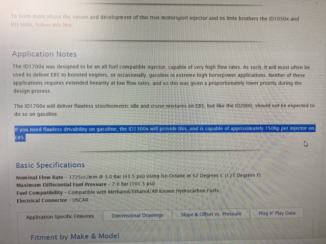

I'll be curious how the 1700 do with idle and cruise trims.
You still plan to run flex?

Not with these injectors

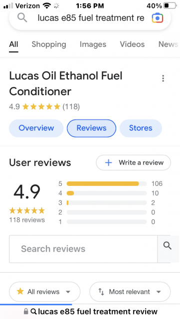

The Lucas E85 Fuel Stabilizer is the trick. I know guys have there been using it for 10 years plus, they never run anything through their vehicles except E85 pump flex and out of the barrel and when it comes time to store their cars for winter they fill them up as much as possible to expel all air (moisture carrier) and just let them sit with the stabilizer in it and the entire fuel system double strength, 2 ounces per 5 gallon. I’ve done that for two years myself so far with no troubles.
https://www.autozone.com/fuel-and-e...oducts-ethanol-fuel-treatment-16oz/977411_0_0

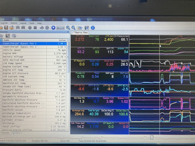

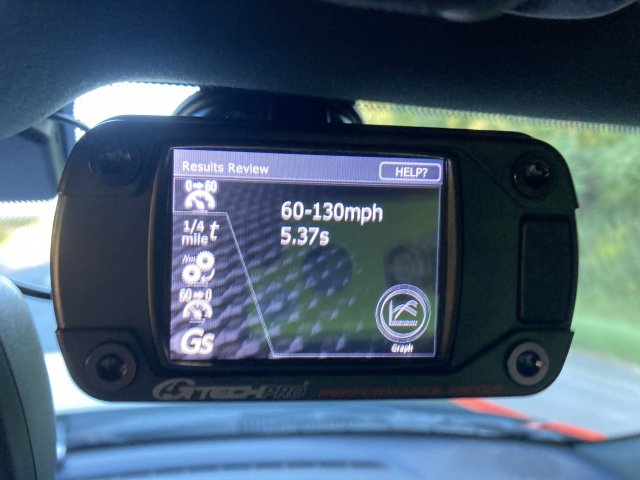

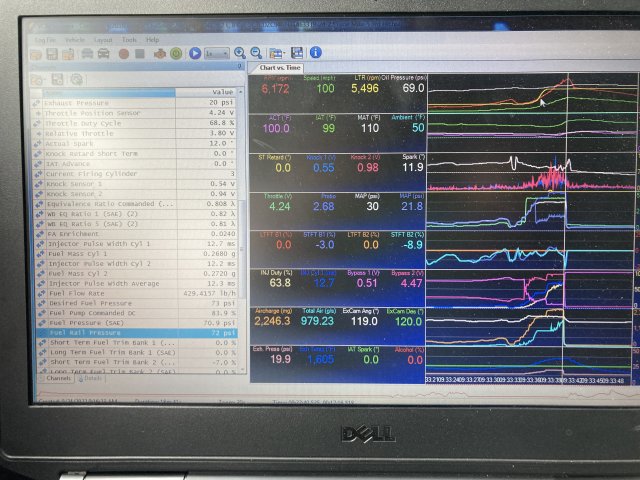

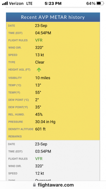

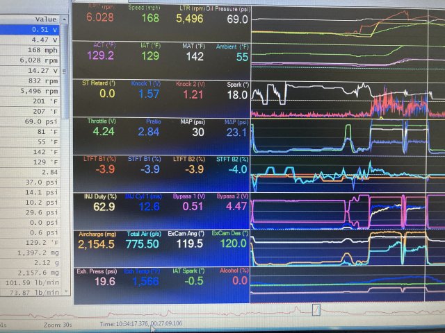

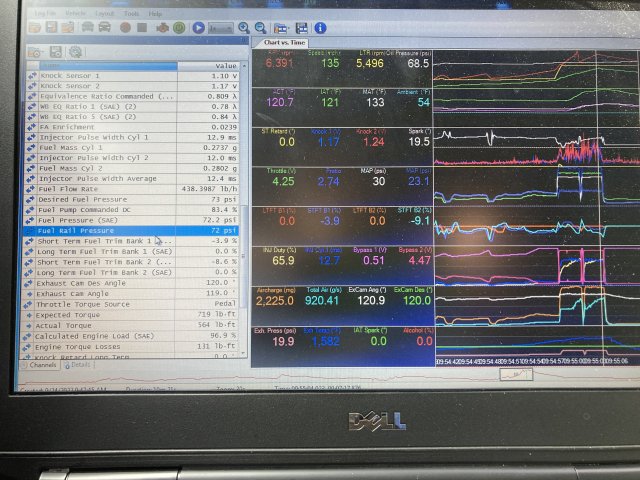

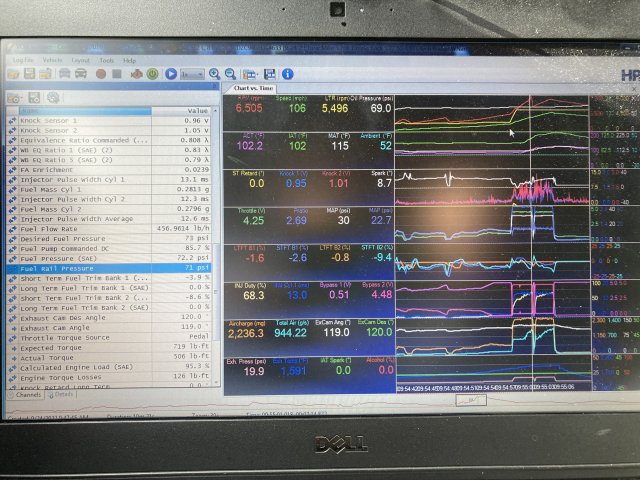

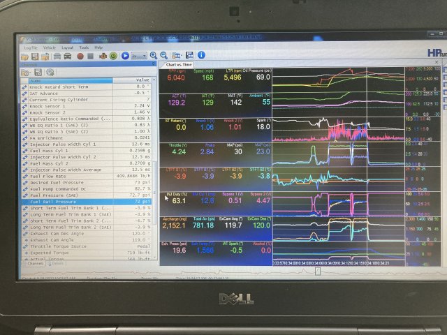

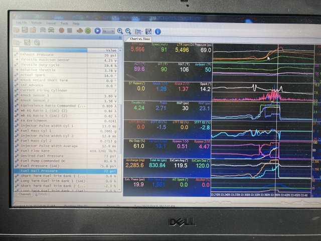

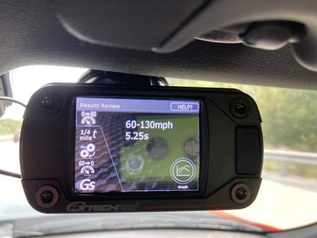

3rd gear pull trims looked good for a 60-130 run do I let her have it. Not bad for 1 hour of street tweaking and a 12 degree max timing safe timing timing table thanks to @jonx96 This engines not a timing hog lol. Back to 19 degrees soon! Draggy battery dead so only Gtech data. Same bridge as usual, no slope, If anything it’s .45° uphill in the direction I ran.

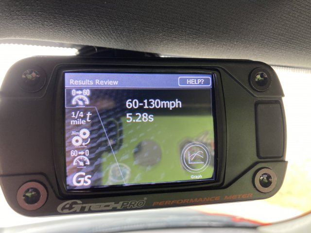

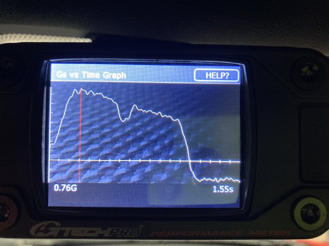

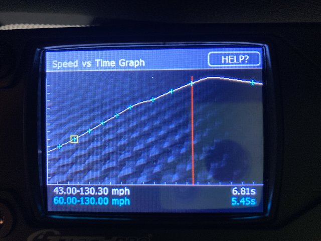

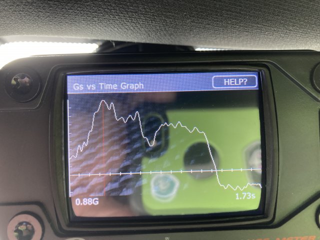

GForce graph of that 5.37 run, shows the declining G Force of the reduced timing up top during the 3rd and 4th gear pulls
8B4FA4BE-3A2B-446A-BA80-B26F2F4B5745.jpeg 93F710D1-53B0-44C1-8FB5-695A3E051CE0.jpeg

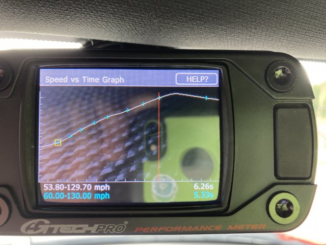

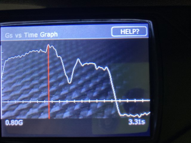

Verse a 19 degree up top run
5F5B9675-7CED-4DFA-8280-1DCE62F12ADA.jpeg 792E0173-A3C8-480E-8F85-929E029ED512.jpeg
Less wheel spin from less timing probably netted the better time.

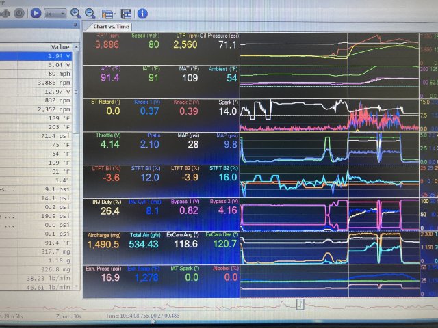

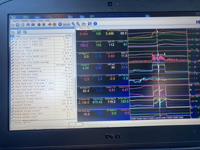

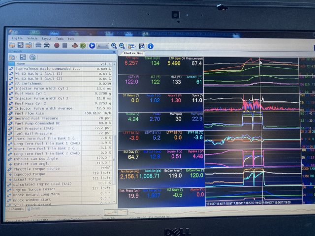

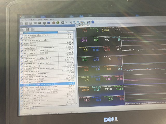

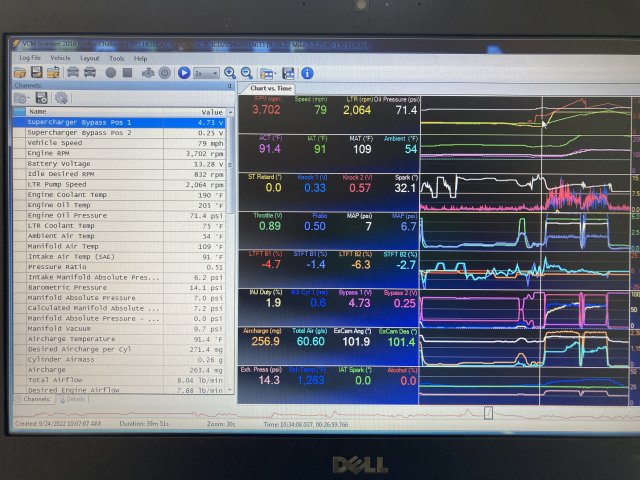

Injectors pretty dialed in now, Still a bit of fine-tuning to do to get them as close to zero as possible but they’re runnable as is. @jonx96 desired fuel curve working well, pump system kept up even on a “extended” run.
