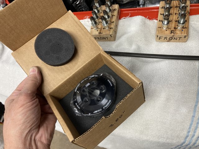

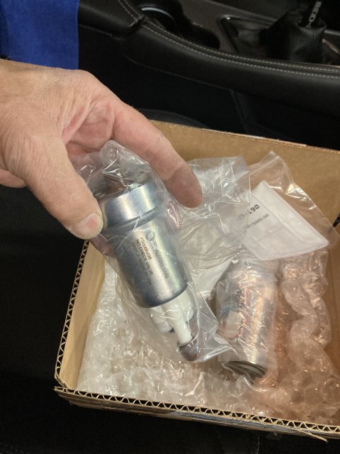

Speaking of fuel system, new fuel pumps arrived today.

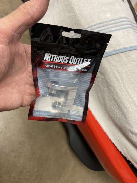

Along with a 3.00 pulley a buddy of mine sent me and that bracket from Nitrous Outlet for the insulator spacers. On Sunday!!

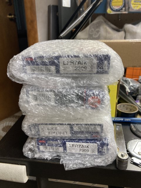

And 16 new plugs too!! :)

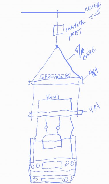

I'm gonna ping you when I get ready to swap blowers. I need those pointers you've picked up on fluid management. I don't have an engine hoist so me and Crew Chief Greg will have to wrestle the blower off the car by hand.

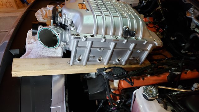

If I had to lift it off by hand with 2 people for the sake of protecting my car I’d sling it just like I did but instead of attaching to the engine hoist if you don’t have one substitute a 2x4x8ft for the hoist hook and lift it that way one guy on each end up and out, easy peasy. To try and lean over the car from each side and lift and walk it out the front is asking for disaster even if it’s just a elbow dent in a fender that’s too much!!!

Where can I get the eyelets to screw in to the blower? I may have to come up with something

McMaster Carr 4843T11 M6 Eyebolt

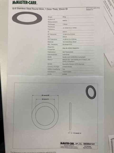

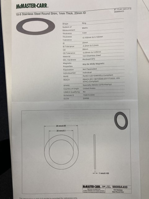

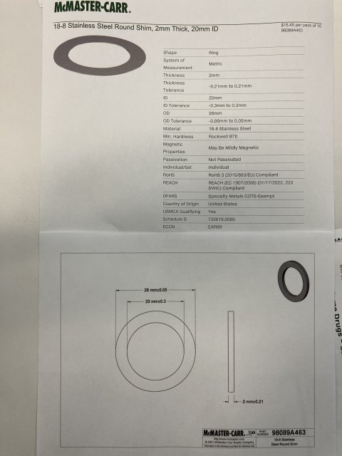

Those spacers for behind Litens pulleys, McMaster #’s below
F5C2E718-3CDA-4A84-884B-B989C2B16B28.jpeg C46D63F5-ED67-4805-93D7-26C2D7902C70.jpeg 5C1924D3-FAA6-45CF-8C10-442CD461E9E9.jpeg

did you custom make the lift cable lengths, or are they some kind of standard bicycle lock type?

They might be from McMaster Carr as well, let me look to see where they came from tomorrow

17,698
55,331

17,698
55,331
Being serious, they are just over 100lbs.
The trick for me was to lift up the front enough to get some short sections of 3/4" hardwood pieces underneath the front of blower and raise it up, then I could rock the rear up and get more sections of hardwood under the rear.
That got it up above the pins.
Then I was able to slide it forward on 2*4s.
Like so...
Then it wasn't so far away and I was able to lift it, pivot around, and immediately set it down on a table behind me.
