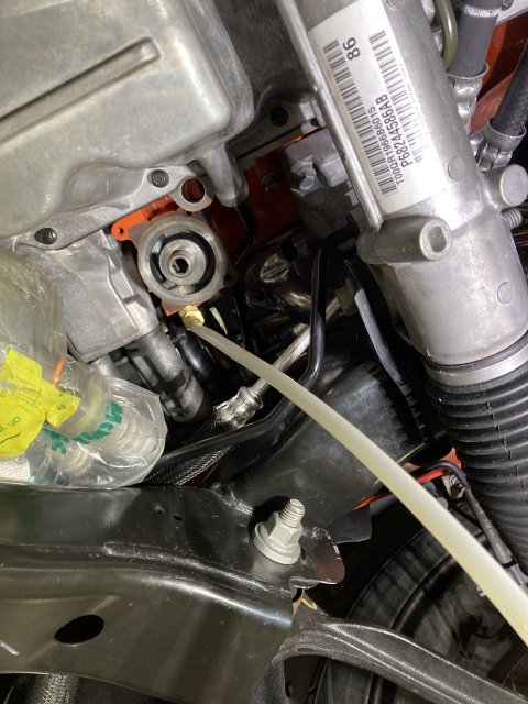

Engines ready for blower, dial the bell in then be ready for trans, maybe make start up for my B day!! Pumped 2 qts of oil in it through the filter until it poured out the top, rotated it over about 2 revolutions while it had 10 psi of oil pressure.
