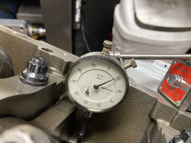

Install 2 piston assemblies, lube bearings snd journals with Driven Assembly Gel, measure and record length of each rod bolt, put cap in place, Tq to 40 ft lbs then 90, measure stretch on each rod bolt to insure its between the .005-.006” stretch wanted by Manley. Verify stretch gauge I made from a desk lamp clamp after every rod to calibration standard I made. F2F3AF15-85D5-4A97-AD27-97F182DF5EF9.jpeg 2C6EA5A1-79A7-4772-BBB2-56263EE69133.jpeg AC440711-5484-49F5-95C2-3E2D459FF422.jpeg FE76C4B8-2D88-4D8D-B214-EC515EE7833C.jpeg 11FCDB0E-8EE8-4402-9407-D5C8DF673576.jpeg A91627F9-ABED-4729-AEBE-32891EF91644.jpeg 0E833EAC-82A0-4A67-A6AD-51057B1F135F.jpeg 755D35AE-DD86-4E20-A911-C3DC1B490E98.jpeg B0DCFE4E-62C3-4BCA-A8A6-E84EE4E3760A.jpeg 74647730-6AB6-48C3-8ED3-43F90F4652D1.jpeg B224EE26-CC64-438C-AE19-CBB806E635ED.jpeg 555A6D4C-6F9D-4C0B-8B02-42A1256B595E.jpeg 60CBE1F9-C047-405F-8C6A-8FDE094EF400.jpeg 4A0BFD8D-C590-4E2C-8544-C1E089E007C4.jpeg E968A594-0B62-4CD4-AD73-D2D51E3A0C60.jpeg 99F9550C-F38C-429D-9C36-85E9C1A71B4B.jpeg 022FB70A-9CB4-4165-8749-D761B6220779.jpeg 97AAABF2-FA2C-4621-904A-4F17F5681188.jpeg 595045A8-040F-4496-B93C-501786259C2E.jpeg 03B2A81E-9882-4673-9A44-1EAB18044FD5.jpeg 26E310C1-2921-4505-AD8C-C9B9BB9E4384.jpeg
Check clearance between each rod set main journals, ensure oil squirters are not hitting pistons. Measure crank end play before and after all pistons are installed, measure piston rock BDC, measure Piston deck height clearance. All passed. Next step change springs, retainers, and locks in the heads to a higher RPM capable Comp Cams .630” lift kit.
