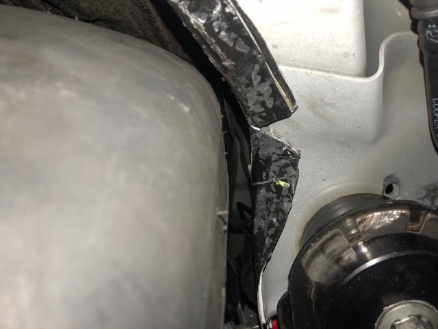

315/60-15 M/T Pro. Absolutely the biggest thing you’re going to get in there without ripping out the entire inner fender structure. E89A99F6-6B86-41F3-A177-F085C93A3C6D.jpeg 667E88C0-D6F7-4C69-AB1B-F49273D4E90E.jpeg
