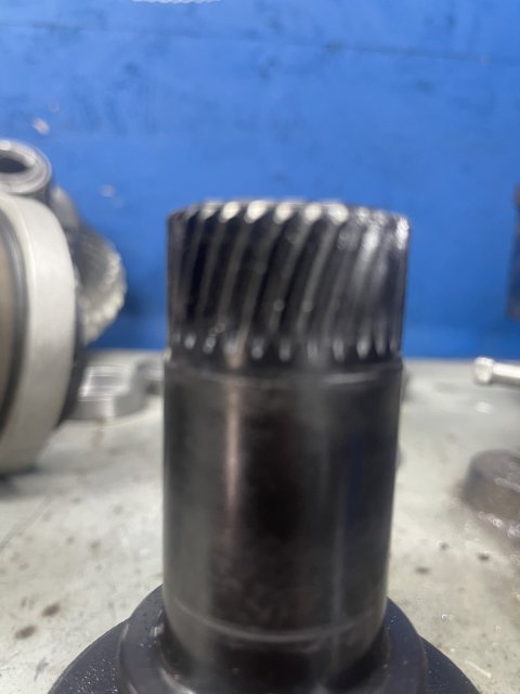

100% plan on doing this. Need to get the current pumpkin out the car. Axles be damned. Just waiting on HHP to get back to me. If they say no I’m just ordering DSS axles and taking GForce to small claims.

I have to respectfully disagree. I bought GForce Outlaw Axles. These are supposed to be the billy badass of axles. I have 15 passes on them and then poof. At 2200 a pair these are not cheap. So what you're saying is that for my street car I should get a TH400 and full solid rear axle… to run 9.5 class.
Make it make sense?
. What I’m saying is concerning the differential. In my opinion, the stock diff case has proven to be a weak point. At the 1000+ hp level it can pretty much be expected to break at some point. Your options are the new billet replacement with stronger (Wavetrac) LSD or go to a DSS 9” conversion with the 35 spline stub option. Either of those will prevent what at this point is just a matter of time with the potential for extended driveline destruction. Axles are a separate issue. I ran DSS with 35 spline stubs with their 9” conversion and never had any issues running 1.2 sixty’s.

From what I have seen they are a really strong axle but not as strong against wheel hop. @jgilj cuts low 1.3 60fts on them
Make it make sense?
What the heck are you doing at the launch to break axles at that power level? I ran the factory axles and factory diff for at least 3 years of racing every week at the 9.4-9.5 ET and 1.3x - 1.4x 60' without issues. I did break a factory axle once but replaced it with another factory axle which lasted until I decided to replace them because I wanted to spray it. At that point I took the path Marc W is suggesting and decided to prevent a failure by upgrading parts that could potentially break and installed the DSS axles.
You might want to consider softening your launch some in the tune.
I didn’t know a 1.4x needed to be dialed back. @Jon-MooredPerformanceLLC

I'm willing to bet the axles were defective from the start. A 1.4 60 at this power level should never have twisted let alone broke an axle. Add in some wheel hop and you have a much different story. but the fact it still went on the pass is weird. every axle I've snapped, sheered, twisted or exploded left me sitting at the line.

462B83A5-E96D-42BB-A393-61192B423C43.jpeg Broken parts happen than you fix them

Maybe along the way - the Converter or something may have done something with the power going to the ground?
Have you changed your Converter?

Linda may be onto something here. I always forget you have a built trans.
