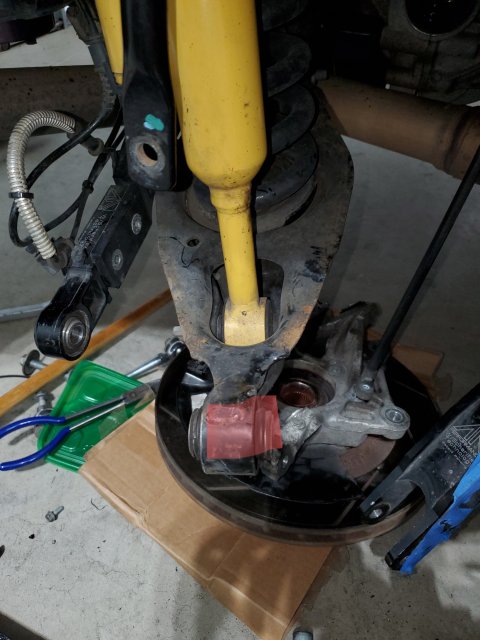

This is where I had the challenge until my buddy showed up to help.
Also don't forget about the order of reassembly and torque so you don't have to partially disassemble it again to get that trail arm torqued AFTER the caliper bolts.

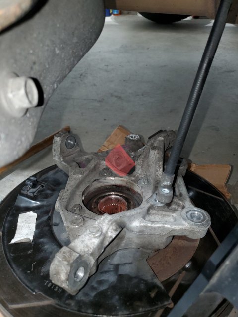

Have you considered using a piece of threaded rod with a couple of nuts and washers to spread that bushing out for clearance ? Pappy always taught me to work smarter not harder
Actually I think that helped me to install the drivers side. Didn't work this time as I stripped the nut doing the pulling. Had to cut it off with a wheel. That sucked. I even tried putting a little heat to it. Still nfg.
