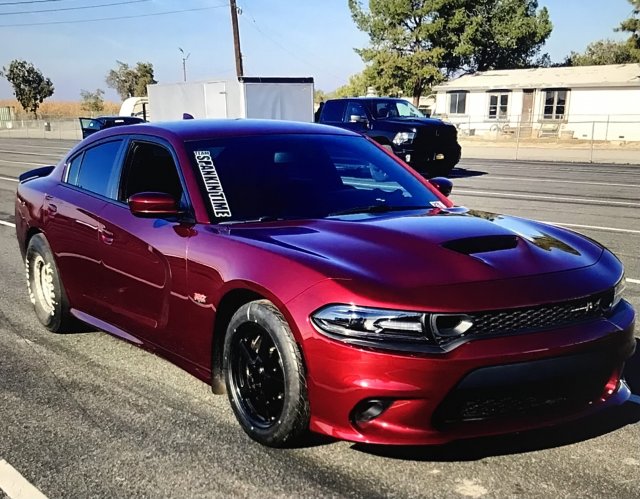

Just for fun 😝. Charger Scat with a 3.0 Whipple. Full weight daily driver on 91 and goes 9.3 at 150 on e85 at the track. Still running the 6 rib belt 😮 4880CF7B-D0CF-4757-892A-9B3793675AF4.jpeg

Just for fun 😝. Charger Scat with a 3.0 Whipple. Full weight daily driver on 91 and goes 9.3 at 150 on e85 at the track. Still running the 6 rib belt 😮 View attachment 108943
Still a 6 rib ? ..that's impressive..
Full length skinny belt on the 10 rib pulley. 579F1653-0AAC-4AA3-8EF6-1B2AD7B682E9.jpeg

Full length skinny belt on the 10 rib pulley. View attachment 108966
I dunno, seems more likely the 10 rib belt broke and the 6 rib was used to drive it home. can't see a 6 rib holding well enough for the boost needed to trap 150
