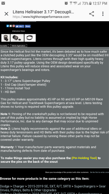

I would definitely go with a litens decoupling pulley.

My son just talked to the president of Litens. He told him that the DS are too long to be one piece. There are 2 places that make a 2 piece shaft but they cost $3200. I'm not dropping that much coin.

My feeling is that most of the crank spinning issues were back when the metco pulley was being used. Now that litens has come out with smaller sized decoupling pulleys I don't feel it's imperative to pin your crank. I'm not going to pin mine.

I should mention that my son talked the president of Litens today and was told that litens is or has come out with a 3.17 pulley that was tested on a stock hellcat. It made 50 more hp and didn't require any other modifications. That's right no tune no injectors just pulley. According to litens pres. The factory pc/tune compensates enough to be safe.
So if your not into doing all the other stuff like tuning data logging this might be the route to take

My concern about Liten's claims is that if you're in -DA, you may run short on fuel running that pulley without a tune. I don't know, which is why I said "may" ... If people are seeing STK with stock boost stock tune, they'll see it on more boost stock tune - but the stock tune may not be able to compensate quickly enough to save you from trouble.

To Jack's point, I've been wondering myself about how well that new pulley offering will truely integrate without a tune. An interesting engineering problem. Especially if you have to operate in a comparatively high temp environment.

I'd have to run some calcs to see what's what on the pulley and no tune. The wide bands are designed to adjust fueling to maintain a certain lambda value, and this may be just under their limit. I'd get with some tuners who've tested it to find out for sure.
