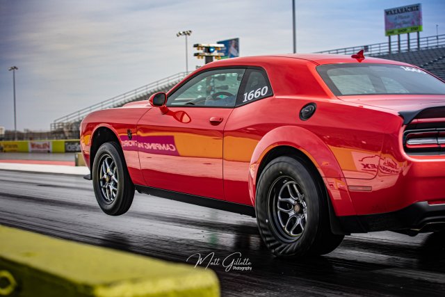

@DRAGRCR, how are you liking the 315/55r17 mickeys? I’ve been thinking of switching to them over my 315/50s. Do you have any more pics of them on the car? I’ve read they should be about an inch taller than the 315/50s?
They are 1.1" taller.
They are 3 pounds heavier, I think.
Wilder said they tested them and the car was slower. I agree. In higher DA with killer prep the shorter tire will be faster.
They will damage the car.
I like them a lot. In fact I may never run the shorter tire again.
They are NOT a cure all. You still need amazing prep and knowledge and skill.
Example, I made 18 passes in Bakersfield on a T&T Weekend. I could never drop the hammer. Not even close.

That is a LOT of wrinklage.
21 PSI and you can zoom in and see that they have not moved much. I think 2" total in 10 passes. The other white paint mark is the light spot of the tire (where the weight goes).

Yeah 315/55R17 tires cause damage?
That thing has some mad wrinkle...either too much bite or too much rub on the hit?
