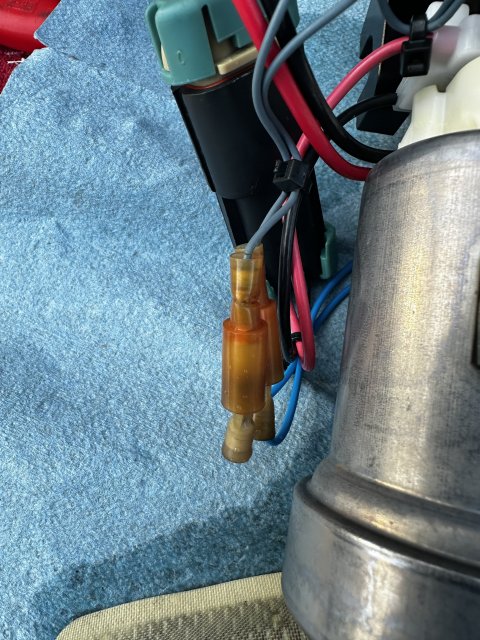

Glad I just pulled em, filters are junk. Arm isn’t getting hung up on wires, but look at the butt connections for the sensor

Not sure what I should use as new butt connectors. Anyone have any suggestions?

They both look burnt/shorted out at the bottom.

I've seen burnt connections in the fuel tank for pump power, the hot wires in fuel tank sorta amazed me the first time. Counting on never being enough oxygen in the tank to to create flammability issues seems like a bad idea, but it works

I'm pretty sure I just solder shrinked mine as there was plenty of wire left to do so and for any future repairs. We'll see what I do with the next card. I should probably pin and shrink it so I can make it removable again.
