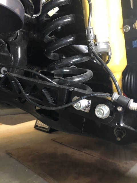

@vortecd under the car today. +4mm on either top arm, and +.5mm on the longest bottom arm. P/s pics first:
B186CB02-8966-4AB6-B3A7-BEA50592D570.jpeg 9C7A6F24-891C-4FB2-A0C1-490DE719FB89.jpeg DDD0B51A-7915-4E79-A618-7B759A1AB887.jpeg A766CEAE-ECA8-4210-8802-C6A84A6183D9.jpeg
On the d/s both upper arms took +6mm with the longest lower are taking another + .5mm
5F4CEB95-0E86-47A8-A8AE-ED36A4C24577.jpeg C4BD940A-8B37-4531-BCE1-50779B4205C0.jpeg D3988D3E-CBD3-415C-B87A-F1D8B14DC5FD.jpeg D8A177A0-1222-4A15-8A6C-690489AFDC69.jpeg

That's less than my car took. I needed 6's and 7's.
Glad to see the toe rods needed minimal tweaking too. They must be pretty close from AAD.
