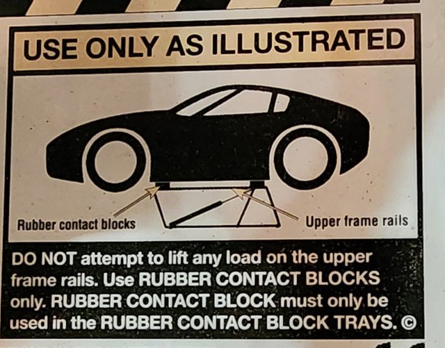

I can't quite picture it at the moment, but at some point I was putzing around and looked at the directions that are right on the labels on the frame and realized that I've been using them backwards for a very long time.
I went to try and lift my truck with them oriented the "correct" way and they wouldn't pick the truck up high enough to get the suspension off of the ground...
Flipped them back around and they worked fine...
So two things, WHY would orientation make a difference on lift height??? :oops::unsure:
And while I suspect the load rating is based on the "correct" orientation, I had been doing it for so long when I realized that I had them "backwards", I just kept going and ignore the labeling...

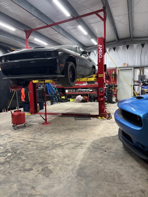

I bought and installed an Amgo 9K lift for $2989 tax and delivered to a hub close by where I picked it up since a trailer wouldn't be able to get in and out of my place. Set up was fairly easy. I used an engine hoist and straps to lift the columns, had some help on the ladder work from a friend and the extra precautions I got talked into (chained to the floor, overhead brace) but better safe than sorry. That lift isn't going anywhere. Wiring wasn't complicated at all if you can read instructions. If my old handicapped as$$ can do it @Speedy! can surely do it. The best 3G I spent in my life.

I like mine. It has been up all season. That is the lower height. All detailed and checked under, oil changed. Ready to get the wheels and tires on later next week and lowered to the floor - ready to go.
I recommend the hangers. You want to be in good shape and use good technique to lift them up onto the hooks. ;)

Huh? I think they are reverse from what I usually do this year, in my picture above. It is because as it jacks up I want it closer to the door is all this year.. Never seen or had a problem either way.

Very nice ..(and safe)...but what's the excuse for the filthy car...[bath][dunno]
I know, I know it's on the list!!

If you go through the various pictures that people have posted, the main legs are either tilted "forward" (pointing at engine), or tilted "backwards" (pointed towards the trunk).
I use my (usually) tilted backwards, which is wrong according to this....
See how the main legs are tilted "forward"...
"USE ONLY AS ILLUSTRATED"
Oops...
