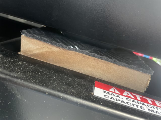

I've been through many cycles with mine, fittings did not fail but the leak with their stupid thread sealant happened. I now use the PTFE paste and it's an easy day. My bigger concern is the stupid rubber blocks they give us. Mine split all the way and dropped it onto the metal, had a brown mark moment. I have since then made my own pads.
View attachment 82500 View attachment 82501 View attachment 82502 View attachment 82503 View attachment 82504
Wait, are you lifting with these under the pinch welds?
I wasn't at one point, that's probably why the pads split,now I have blocks permanently attached to the pinch welds.
Okay, good.
That's bullshit. Bet that was alarming to watch
