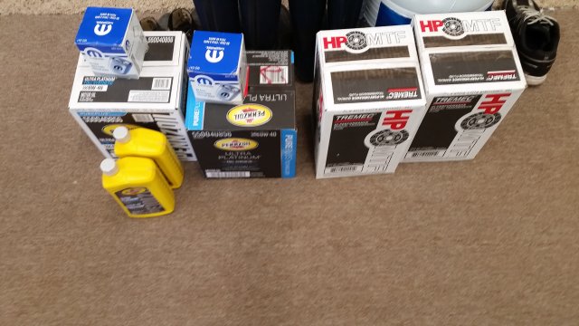

No CDV yank or skip shift bypass for me yet but I do recommend changing out the factory fluid with the TREMEC HP MTF. 20200314_100828.jpg 20200314_110719.jpg

No CDV yank or skip shift bypass for me yet but I do recommend changing out the factory fluid with the TREMEC HP MTF. View attachment 61658 View attachment 61659
Thanks! It’s actually Redline but hard to tell in pics sometimes.

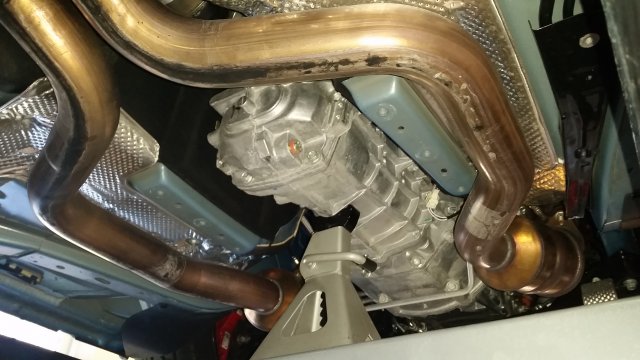

Did changing the fluid quiet down the gearbox? That was the first thing I thought about but I’m pretty sure I’m hearing the throw out bearing. Difficult to believe the throw out bearing would be bad after 4 years and 21k miles though.

The TREMEC fluid is definitely noticeable in "feel". More buttery shifts I guess you could say. Didn't notice any noise delta but mine was very quiet before.

Yeah it’s definitely the throw out bearing I’m hearing. I may just be hyper sensitive to it though and I only hear it at slow speeds when engaging/disengaging in the 1-2 shift.
It doesn’t sound bad, I can just hear it, maybe I’ll just make a piece of insulate to mount below the shifter boot when I install the Barton.

might be worth it to have the dealer check it out, my M6 with 10000 miles was extremely hard to shift from 4th to 5th under hard acceleration, Dodge replaced the transmission no questions asked.

Yeah I’m going to get the car up in the air and take a look at everything (just to make sure there are no surprises) and then I’ll likely take it to the dealer and let them take a look. It still has some powertrain warranty on it, I’d assume that’d be covered.
It makes the most noise when I’m at a stop with the car in neutral and my foot off the clutch pedal. The minute I engage the clutch, the sound goes away, that’s why I’m assuming it’s a throw out bearing.

Thanks for that info. I’m swapping it for the Barton anyways, so we’ll see. I’m 99% sure it’s the bearing though, which I’m hoping Dodge will cover under warranty.
If not, no big deal. I’ll live with it for a bit (not my daily driver) and pull the transmission when it gets warm haha.
