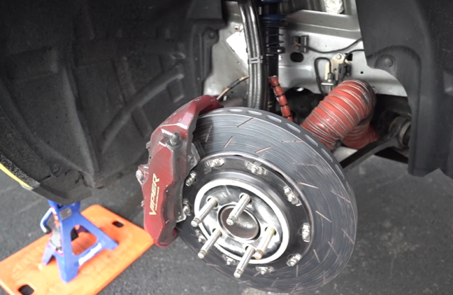

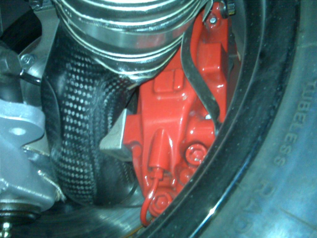

My main road block is how to mount a duct and direct it to the center of the rotor.
Onur Can made something for his Charger but it went to the rotor surface. Not a show stopper but not as efficient.

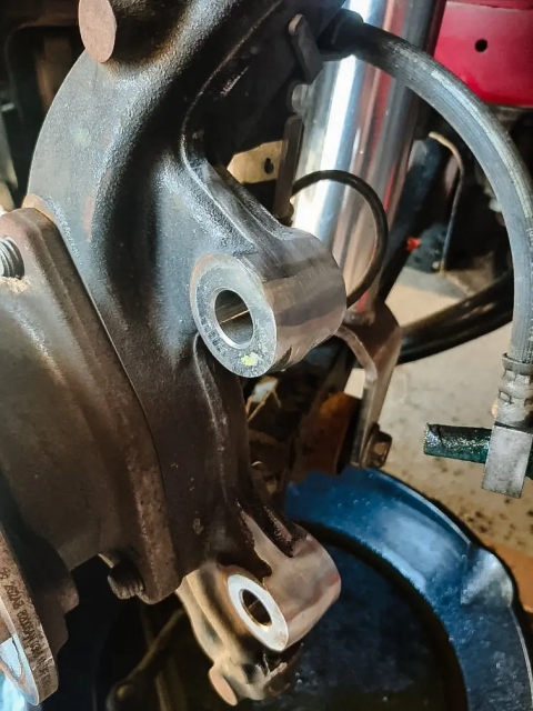

Need a pic of the backside of the rotor

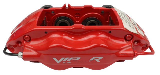

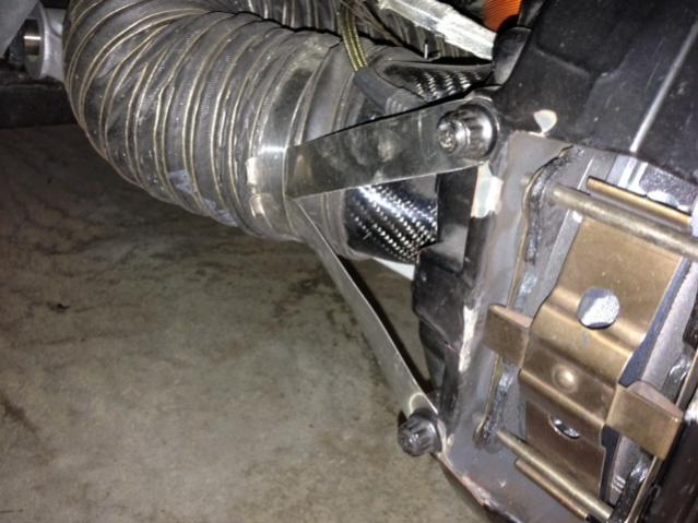

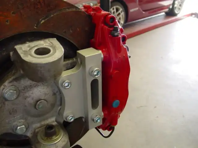

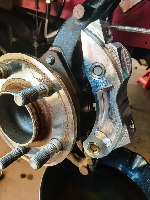

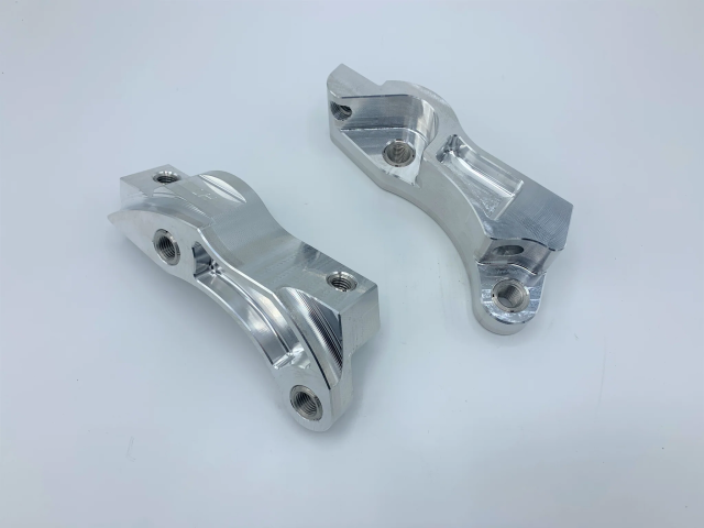

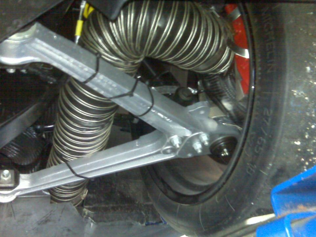

This is from the Viper forums. Viper ACR Caliper adapter and fabricated connector from the duct.
