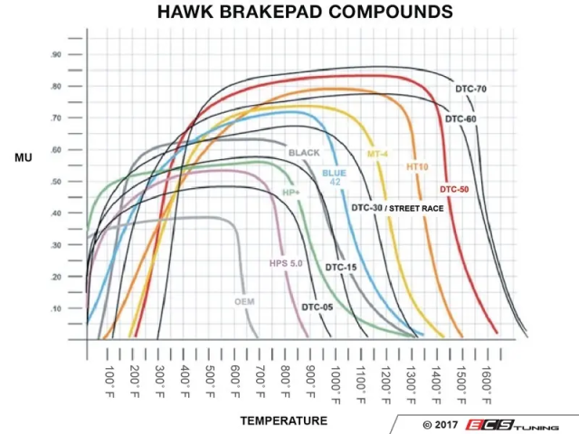

Hawk DTC-70
  • Type: Motorsport-grade race pad
  • Material: High-performance race compound
  • Friction Coefficient (μ): 0.80 ~ 0.90
  • Operating Temperature Range: 400°F to 1,600°F (204°C to 871°C)
  • Optimal Temperature Range: 800°F to 1,200°F (427°C to 649°C)
  • Torque: Extremely high
  • Initial Bite: Aggressive and controllable
  • Modulation & Release: Superior

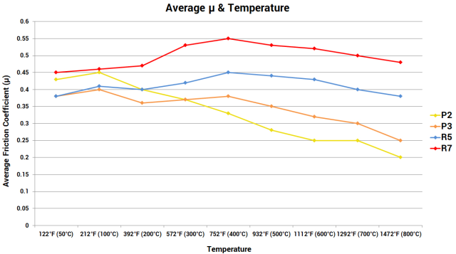

Paragon PBP690T6-15 R7
  • Type: Advanced high-speed track/competition pad
  • Material: Metallic
  • Friction Coefficient (μ): 0.48 ~ 0.53
  • Operating Temperature Range: 212°F to 1,562°F (100°C to 850°C)
  • Recommended Use: Advanced high-speed track events, competitions, and heavier cars requiring maximum braking performance

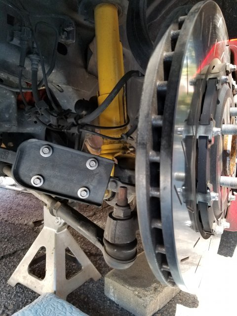

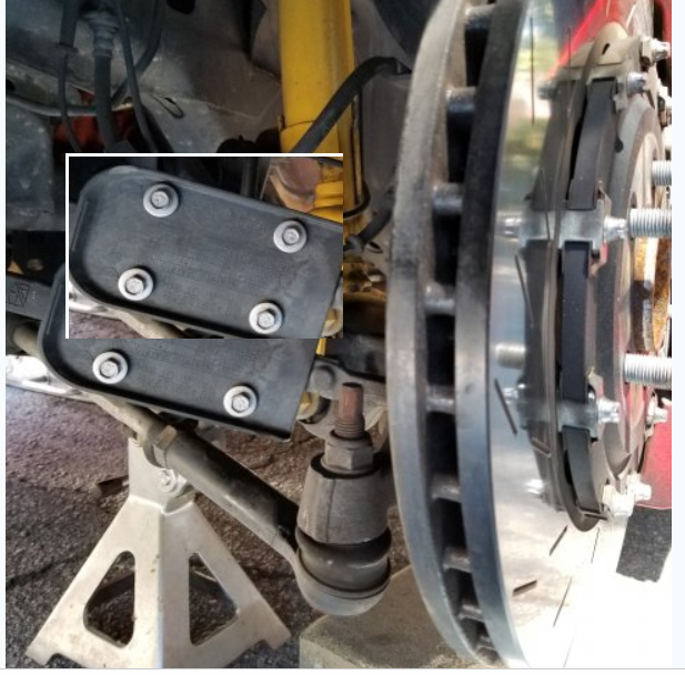

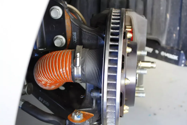

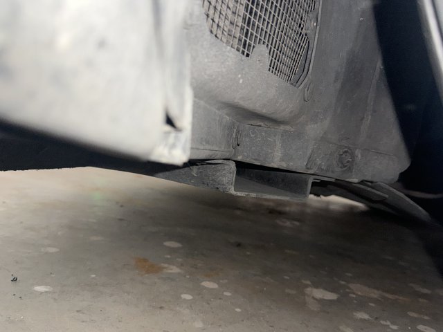

Thoughts on directing cool air to the rotors aside from the updated belly pan with brake ducts and additional air deflectors?
Could double the size of the current brake deflector by overlapping with another kit.
Or attach brake duct to the current brake deflector from the underbelly duct:

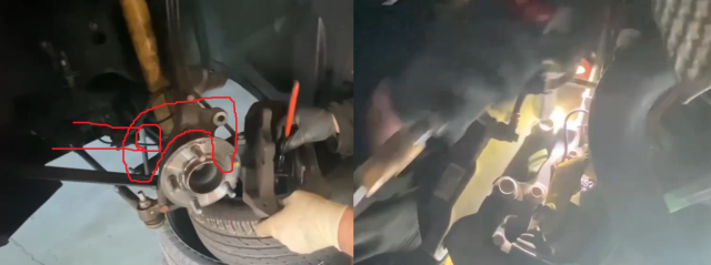

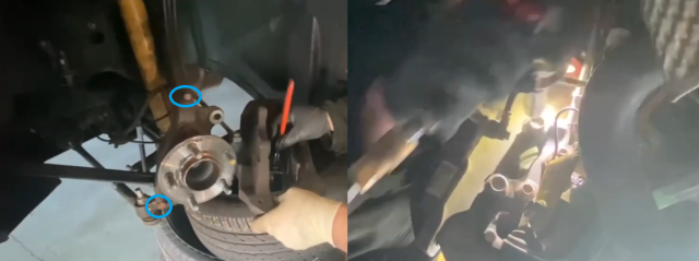

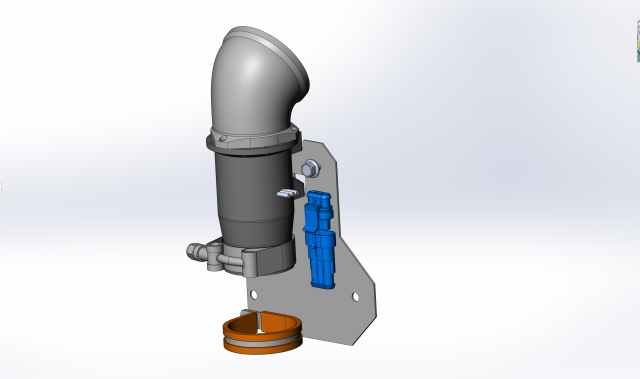

Perhaps adding something fabricated like a dust shield with brake duct tube (visual reference below) and attaching it to the caliper bolts (red). The areas in blue used to be the dust shield mounting points for the older SRTs with smaller rotors.

Anyone have a solution as to how to mount those brake ducts on the AAD suspension parts?
