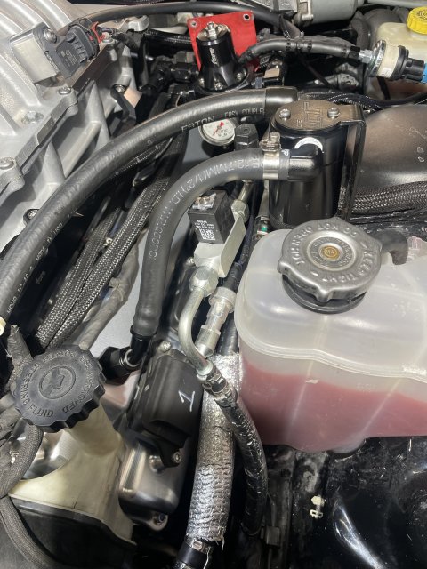

Semi buttoned up. New an lines on driver side. Spent 48 hours thrashing, wouldn't have it any other way. Time for bed, gonna do the coolant side during the week.
