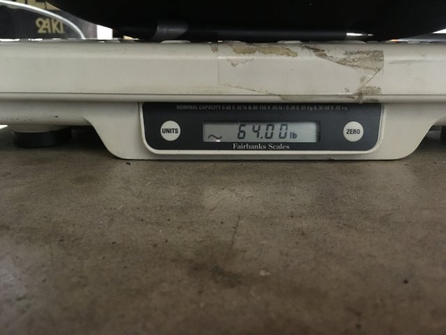

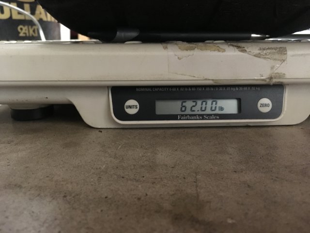

Stock 275 on OEM Brass Monkey 20” rim weighs 62 lbs and a 315 on a 10.5 replica weighs 64 lbs, that’s not too bad? Trick is to always have a stud at 12 o’clock position, sit on ground in front of tire, put a leg on each side of tire knees about in middle of tire and help lift it with your legs, Makes getting rim/tire combo on MUCH easier this way, no banging up the calipers or rims either

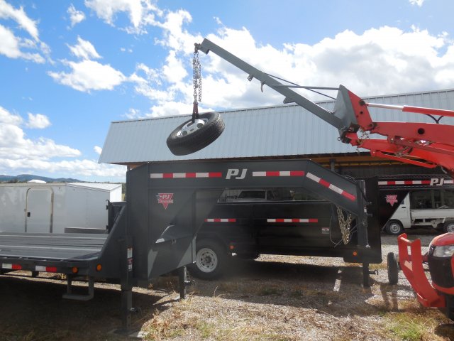

Okay, full disclosure: When faced with lifting a 100-lb. or so tire and steel wheel assembly some 6 feet up, I also cheat.
Using a home built "sky hook" and the tractor was much easier than wrestling this trailer's spare into place by hand.

Work smart, not hard.
6,408
11,976
Thank you, I almost wrote that myself. But didn't want to seem lazy.
