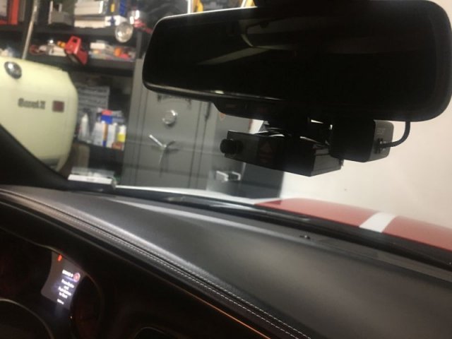

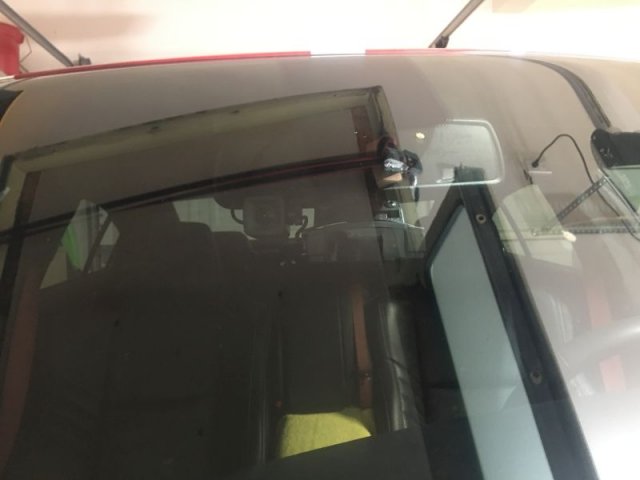

A little input for anyone running a V1 or similar RJ11 powered setup. As stated previously, I am using a mirror tap with RJ11 output, and a V1 on a blend mount. I've also removed the lower part (links) of the blend mount to get the detector up close to the rear view mirror. I wanted to run a dash cam that would work with this setup without running more wiring. So I decided to purchase the Escort M1 cam and a the mount kit for it from blend mount (its just a longer screw with an Allen key). This setup seems to work. When the car accessories power up, the camera and the detector power up with it and shutdown when the car is shutdown. Both seem to get enough power from the single power tap. I haven't got much time on the setup yet but so far so good. A few poor pictures in low light, with lots of reflections and a crappy iPhone camera. 1st from out side looking in the front window and then from the passenger side looking forward.
