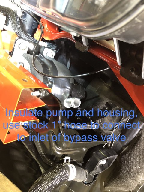

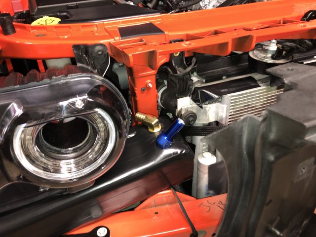

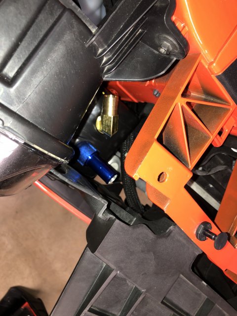

Insulating to the degree and neatness I did took easily twice as long as putting the parts together, it was a process and a toil trust me. It’s insulated like that right back to the pump inlet, pump, valve to the unit. Under the headlight and behind the number facial it all hides. Even this slick bleed Tee right under the hood latch cover.

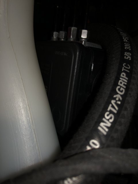

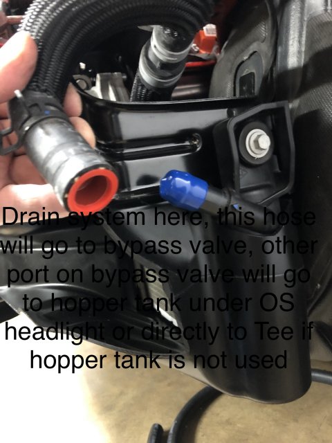

Here it is before being insulated and then picture installed 4B63D5D8-91A1-48AC-BEC2-80A5541F7D9D.jpeg 342E1714-FB39-4C49-A0BA-8B7EC01C2D01.jpeg 66273D5F-6C98-4674-9F0C-82706316AC0F.jpeg
The Drag valve is another motorized valve but is just off/on and located in the suction line under the air box. I insulated it to protect it from radiant heat
