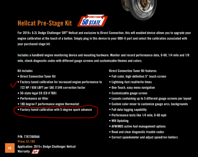

I was saying, just do your research and really understand what you're getting. Most people won't, and Dodge is counting on that I'm sure. Notice they call it a "touch screen device" which misleads you in to thinking it's the build in touch screen and will work like the Demon when in reality it's a hand held tuner you mount to the windshield, IE Diablo T2. So what that's gonna mean is you have to load tunes and data log and a lot of you guys seem to want to avoid that.
Also the part circled in red makes ZERO sense especially for the "pre stage" kit. It says you pick up a measly 5HP but then says it's a factory tuned cal with 5 deg spark advance?? What's that mean? 5 deg on top of a normal cal would net over 50RWHP and it's not possible to do that on pump gas anyway. When you finally step up to a pulley you get 40HP for over $2,000 BEFORE install charges to keep that precious warranty. 40HP wouldn't be worth it for me. If I'm going in there I want 100+.
@DGatzby 80% of the performance improvements in custom tunes are in the transmission and throttle response. I don't see them mention transmission tune updates, did I miss it?

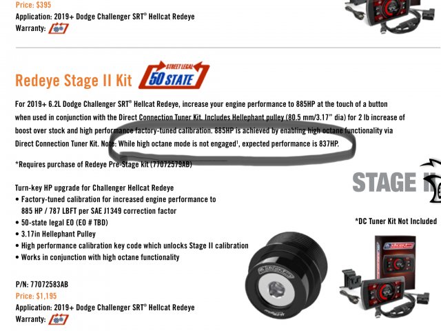

Just saw this....the last sentence is a good thing so they are going to take advantage of the way some of the Demon HO stuff works, and drop out of HO mode if knock is detected, but that first sentence is the "out" as it were.
@DGatzby you don't get 840 on 93 sir. 100 octane required assuming you're talking about these Stage kits.
Don’t we get the 838 stage two with the increased boost?
"Maybe"? but I'd be REAL leery of running that on 93 personally especially for what you do with the car. The pulley brings you to 16.5 PSI of boost and that's a lot for pump gas in one of these. Mine makes 17 on the 2.72 and remember how that was never recommended for pump gas. I don't hammer it on 93.
837, 838, 840 WTF among friends, close. Let’s see if this is not some conservative number under the proverbial 840 hp high octane Demon Tune. Interesting it takes a Demon 100 octane to do this, but a potential tune for a RE is the same on “pump” gas.
