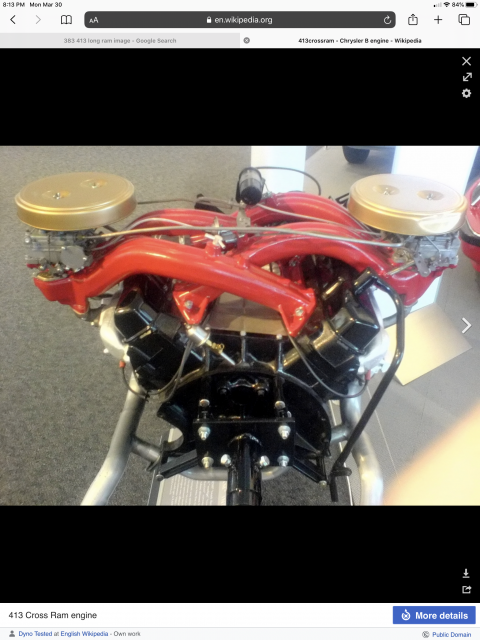

@Hpindy...there was no 383 RB that I am aware of, all were "B" blocks. If you ever tried to fit an intake from a "RB" to a "B" you will quickly understand the difference.
Exactly, the deck height on a 413, 426 wedge 426 hemi and 440 were all .750”. 3/4” higher that brought both intake and exhaust manifolds up higher. Although like Pontic “ouch” a lot of the internals could be mixed to get more displacement.
case and point. Hot swaps are 400” low deck with a 440 crank thrown in is the hot set up especially the ones with thick main web castings. I think some 73 or 74 years had em.
There is I believe one caveat that allows a low deck factory intake to go on a RB block, that would be the the 383, 413 cross ram, AKA long Ram manifolds because they were a 2 piece manifold with opposing runners feeding opposite cylinder banks see attached
imagine those long runners with our power chillers and a couple of laughing gas NO2 plates under each AFB carb
