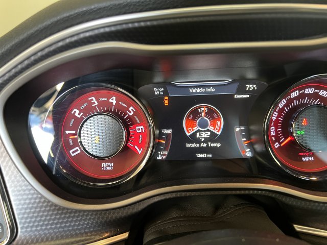

FWIW, this is the software version that I loaded with a USB drive some time ago. The IAT matches. ('16 M6)

That all looks correct to me?

My 2015 auto has 18.45.01.
I believe that's the most current one when I checked the Uconnect update site, today. Are your IATs in agreement?
