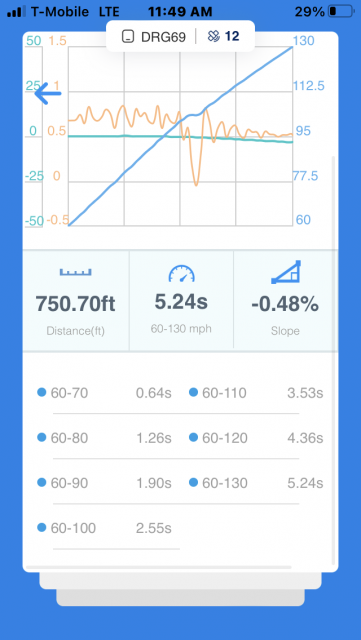

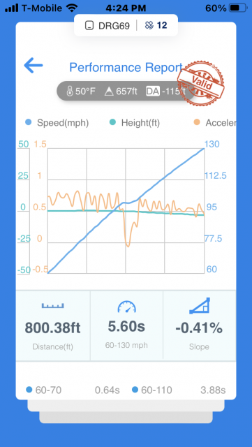

On the Yes, can actually feel it, see it on HP T log, and see it on Draggy runs even between the 3-4 shift and at the top of 4th cuts right around the 130 mark.
901AB55C-3807-49A5-BAB5-922423F7457A.jpeg 2C6A2165-F3A7-463F-8897-CC5B9B70F633.jpeg B0EE19BA-8489-48F7-8024-3640DF31F9C1.png
Here it is fixed by @jonx96 , gained me a 1/2 second on my 60-130 times. Took care of it within an hour of contacting him. I don’t know how people can wait 2-3 weeks for a reply or revision, summer would be over by the time one is tuned.
New Personal Best 60-130!!
THANKS @jonx96 your #1
2FF528D7-9AED-490C-8AC2-60A056F4262B.png 3549290F-FAE1-4E53-BE64-0666FF9B723A.png
Clean at the shift now!! Making some steam even at low timing, she’s got more in her for sure!! THANKS JON!
