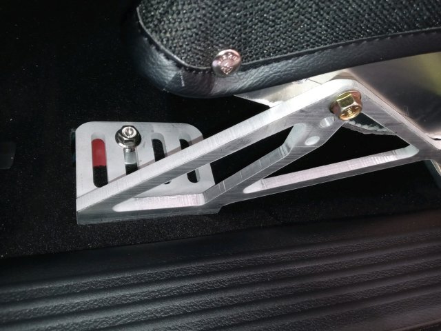

OK, so if you do not want to make your own brackets we have come out with some that are really trick. They are really strong considering how light they are. Made from 3/8" aluminum. I was buying brackets from OMP for about $210 shipped and then extensively modifying them. Now you can buy these and use them as is. They are about 2 pounds each. $450 a set. I beta tested some with a 20" kirkey today. They will also work with a 18.5" and they can be used with a 17" along with spacers same as I was doing before.
