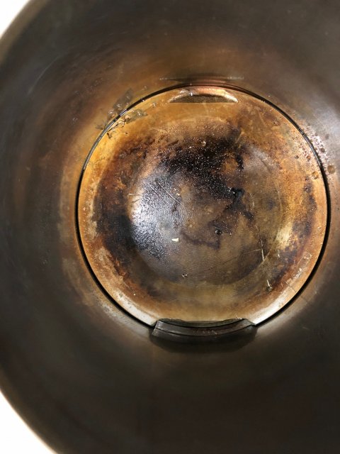

On the 5.7 and 6.1 HEMI platforms (and especially the 6.4), the ring lands were a problem. .
I can attest to to 6.4 ring lands....

Was this on a stock engine, modified, with or without boost?
No boost. Just ported heads, long tubes, cam and tune. Stock internals.

@Stl376 - that looks like the exhaust side of the piston. From memory I think it was usually the intake side that broke on supercharged applications at least. Looks like in your case it just got the ring hot, probably from running a bit lean.

Interesting that the ringland failures were favoring a certain part of the piston. I find it very unlikely that the ring gaps were all in that orientation from the factory and remained that way throughout the lifespan of the engine. Would be very interesting if that was the case.
Of course I’m assuming that the primary point of failure would be where the gap is sealed and the 2 ends are fighting for space.
Seems intake side was prone to over heating.
