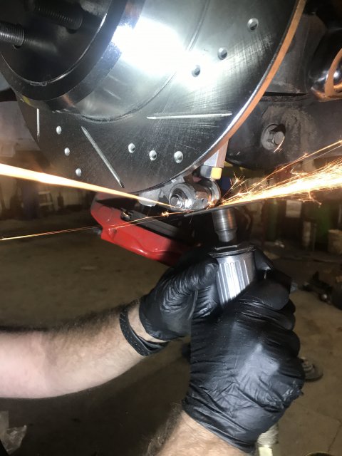

Thread Starter #22
As you will see here I had the grind sway bar link all the way down to where the ball pivot starts after I got my clearance that I wanted with it all installed I took the cut off wheel as you can see in the pictures and I smoothed it all out with the mounting where the sway bar link bolts to the knuckle
This actually gave it a smooth rounded 8930BB87-B74E-47FF-87AD-D1A207CF864C.jpeg 9CE13161-78EE-4E5B-99A3-9559FAE4E0F9.jpeg it look

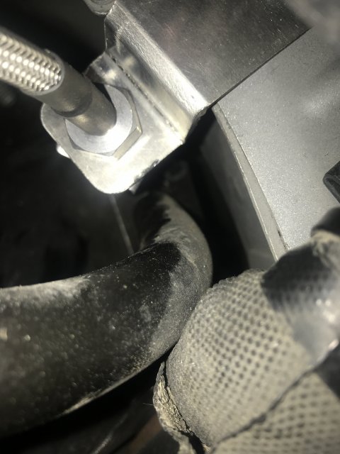

Thread Starter #23
Since I don’t have the upper control arms and one of the lower trailing arms was not correct I went ahead and installed the brakes I actually think the Carlyle racing kit is actually OK looks like a solid brake system as I’ve got the drilled and slotted rotors there’s some pictures in here that you need to pay attention to the brake lines especially where they go over the sway barYou will want to make sure that you slide the rubber back in between the sway bar and the brake line to protect the line , on the passenger side brake line from thecaliper AA5CB11E-3E93-47AB-8283-E0CD381540C6.jpeg C8ADEA1F-BFA5-44DE-BFF8-7FCCB6A5192F.jpeg 651F8447-9030-445B-9435-819C76800688.jpeg 2E799868-CBE3-4D1E-AF67-C78407B6E5ED.jpeg F79CC125-843F-4BF6-9A65-77CC86B64FBC.jpeg actually goes in right in place and isn’t going to rub against anything but on the driver side at the top strap the brake line in one area to the fill hose of the gas tank to prevent it from rubbing, also when tightening the brake lines be careful they just need a good snug don’t heman them
