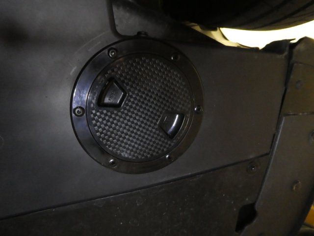

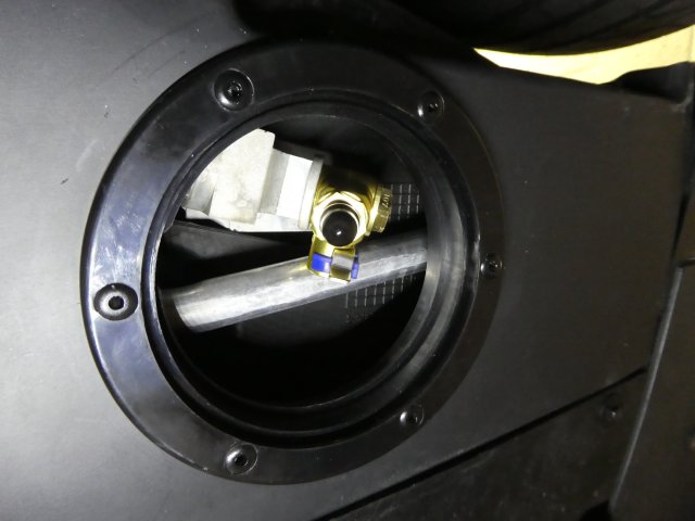

If you got the access panel that a member was selling a while back it’s a piece of cake. If you are original, it’s still not hard. You’ll just have like 19 fasteners instead of 8.
1,551
3,882
did this on mine for oil cooler drain access - saves a lot fastener R&R as noted above.

Not filter related, but I installed Stahlbus valves, on my Cat. Not enough room, for Fumoto valves. Keeps things tidy, during drain ops.
https://www.stahlbus-us.com/oil-drain-valve/

Hmmm, well I have two Fumotos on my '16 and they fit just fine - one is shown in Post #30. Need to know the right models to use ;-)
Yeah! That looks good.
I considered that model, but went with Stahbus, instead. Ran Fumoto on my 6.1 and the wife's 5.7 Magnum, for years. Figured I'd change things up.
Thanks for sharing.
