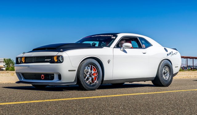

I don’t think lowering springs are helping your situation any. I went with the Mopar 1320 Scatpack Drag Springs. They come with light weight front and rear sway bars. They do not raise the front or rear of the car like the Demon or other weight transfer springs do and they ride nice. Softer than the Hellcat springs which is a good thing after all the bushings and control arms tighten everything up. As far as the Whipple thing goes.... ask ZHC about what it takes to get his 427 Whipple down the track. Track tuning! Obviously he knows what he’s doing and because he’s tuning his own car, he can invest as much time as it takes to figure it out. I took mine out for it’s maiden voyage down the quarter mile and made one pass. DA was 3000’. Decided to start with the tires at 20 lbs. That was my first mistake and I learned something about the Radial Pros (they need to be a lot lower than that). This was a initial test pass with zero track tuning to get some data. 4.0 pulley with 3.25 gear was going to be a challenge and with the tires at 20 lbs....it hooked up at half track when the tcm said screw this and short shifted into 6th gear. It ran 9.61 at 147 mph with a 1.57 sixty ft. So that’s the starting point and the challenge is the same as yours...... put it to the ground. Because I don’t drive the car out on the highway.... my decision on how to do that is easy. I am not going to spend countless passes down the track, logging data and swapping files to get a handle on the tcm. I’m not going to burn up (or break) a hp90 or two in the process. The T400 is ordered and that thing will put the power to the ground and shift when I tell it to.

Also.... in case you (or anyone else) is wondering how it sits on those 1320 springs.... and that’s on a 31” tall tire 754B2C72-A2F1-49E8-BC30-BE644CA493C2.jpeg
