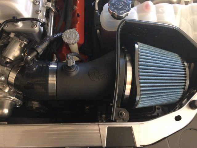

Good job @Speedy! , I tried the JLT & then went with AFe Pro 5 R , which I like a lot.
Like you , I hide the clamps on the back side lol.
To see if the box is sealing to hood or how close it is , pull the hood vent out & filter off for room & close hood & put phone in the vent hole to video around the box. Then you can see if its close or not.
Had a LMI also and went with the aFe Pro 5R and I like it better too.

@Mean Cat, what is it about the AFe that you prefer over the JLT?
I don't want to down grade JLT bc its a good CAI but for me the JLT did not seal to the hood as claimed ( removing the hood vent & videoing inside is how I found out ) , the filter is almost too big for the box as it pushes to the end of the box , & the box just looked too big sitting in that spot.
The AFe doesn't have a box , it has a engine bay block off panel that does seal to the hood a lot better in my case & doesn't look too big , the filter is big but doesn't look squished in that area so it looks more natural in that spot. It comes with a pre filter for rain but mine is not a DD anyway.
I did get the JLT hood vent block off panel that I keep in the trunk just in case needed but with it off you can hear the whine from s/c better , which I like.
