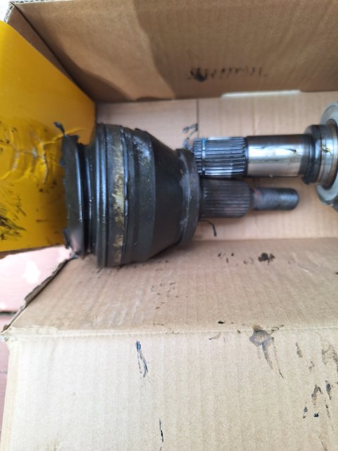

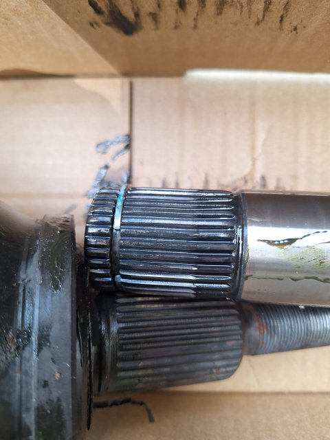

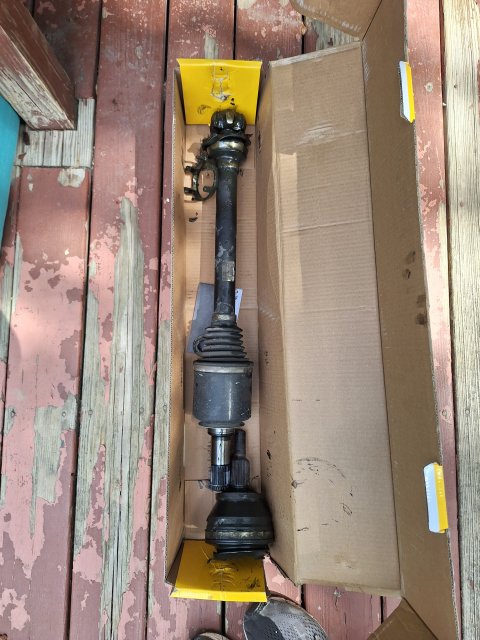

So. That Driveline vibration? We found it outside of South Bend while doing a highway hit alongside a Tahoe that was being a douchecanoe...
20260621_104832.jpg 20260621_104839.jpg 20260621_104845.jpg 20260621_104850.jpg
Outer CV immediately exited the chat. Driver's side axle. Never found any of the balls and you can see the twist in the diff splines.
The D&D community came in clutch...Allan got us to a safe spot with his tilt deck, offered up tools and got us to a hotel for a night. Jeff got me a parts store axle on the corporate account which saved almost 30%. Rental car, hotel, consumables, axle and tip was 700 all in and 18hr delay.
So...which axles are the best for our cars? Cause the passenger side is also on the way out...

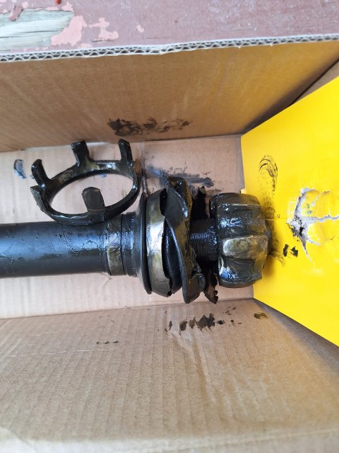

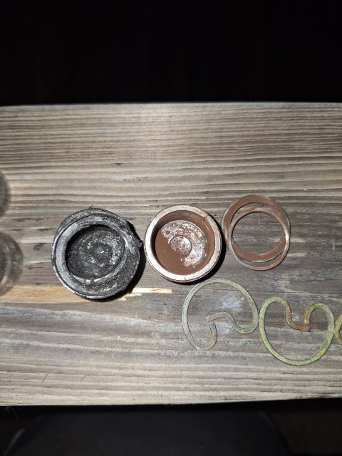

We also discovered this in the front of my CCI driveshaft after 5 years of getting it's dick kicked in...
So. 2 new 1350 spicers and a busted Laser 10mm 12pt torque adapter later (4 bolts from being finished nonetheless) we got the driveshaft rebuilt on a trash can using a ball joint press and tossed back in the car. The problematic exhaust had all new clamps done front to back and aligned but is still off at the diff brace in the rear (recurring issue for me) but that's an easy tweak. Road tested anyway and we are good to go til at least 155mph now again...
