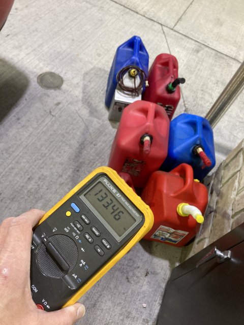

I went to the high station just before and stocked up on 83% E before this last station starts changing over to winter blend as well. Going back with 4 more new jugs over the weekend too lol. I need enough good stuff to last until at least mid November.
8D0C9BAA-85F1-41E9-9B90-7F0DAB76EE85.jpeg 3B17FAC9-7626-47FD-9C1A-A159F7C4A2F4.jpeg
