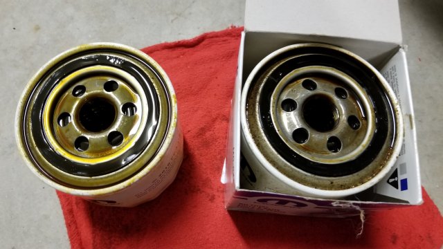

I was advised to change oil every 3K on E85 so I stick to that and I don't think the amount of time between oil changes matters nearly as much, its really about potential oil contamination which comes from mileage. I've been running E85 primarily for the last 14K miles since my car is a daily driver. I've had my oil tested twice at Blackstone Labs and both times the wear results have been normal. I even went 4K miles on one sample since I got behind on my oil change schedule and the oil sample was still normal. I'm due to change my oil again this upcoming weekend and I will send a third sample to Blackstone so we'll see what this one shows. I missed sending a sample on my previous oil change because I forgot to order more oil sample containers.
Here's a cool picture I posted on the other forum months ago after changing the oil in my car and my wife's Hellcat on the same day. Mine had 3K miles on the oil change (left), my wife's had about 4K miles on her oil change (right) but you can clearly see how much cleaner burning E85 is and its affect on the oil. My oil still looked very clean, my wife's Hellcat which only runs 93 octane looked black which is typically what you see on pump gas engines.

That oil looks much cleaner with E85. I'm trying to think of any single reason NOT to run E85, lol. Figure as long as I know the alcohol percentage it should be all good. The benefits seem to outweigh the drawbacks.
