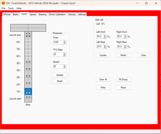

@rayzazoo I need to understand a lot more around which screens (settings) and how we are entering the numbers. In the short time I viewed the “tune” downloaded from the car, I don’t see anything but blank entries, except for the first screen that has the % shock values and the acceleration screen. I have until Oct 17 before putting it on the track at RA, to play with the Track settings, and then want to understand the system so depending on how she works I can make some changes on the fly.
Can I ask for some help to better understand where, how and what is going on with the mA settings? Where are the fundamental rebound settings, or as we increase these is all that taken care of either to a lessor or greater degree? Let me know if you can help. I am also going to watch all of their tutorial library today. Hope to be smarter soon.
Surprisingly, most of my adjustments are on the accel table. I think the brake table is already good. There are only 3 mA settings on the shock calibration table. You could go progressive but it'll result in softer vs. 3-button and suspension scenarios.
I spent most of the time understanding the 400, 200, and 100 mA transitions between accel, gForce and speed tables mainly to eliminate large transitions between tables. That resulted in the following.
Sport Accel Table:
10-80% is 50.0 LF/RF and 20.0 LR/RR
Launch Start 50.0 LF/RF and 20.0 LR/RR
Launch End 50.0 LF/RF and 60.0 LR/RR
Threshold 1300
Track Accel Table:
Threshold 1500

Surprisingly, most of my adjustments are on the accel table. I think the brake table is already good. The main thing is there are only 3 mA settings on the shock calibration table. You could go progressive but I think it'll result in softer vs. preferred firmer scenarios.
I've got a longer USB cable being delivered so I can datalog.
As a starting point. I spent most of the time understanding the 400, 200, and 100 mA transitions between accel, gForce and speed tables mainly to eliminate large transitions between tables. That resulted in the following.
Sport Accel Table:
Threshold 1225
Track Accel Table:
Threshold 1225
The tutorial helped me. Let me get into the numbers and even write some stuff down so I can talk smarter.:ROFLMAO:

Okay! I have a much better lightened schedule now. I have been driving it around. I cannot wait to go and run some laps at RA. I think it is different. It’s more flat in turns, I have done a few round-abouts and especially leaving them, to try to gauge what feels much more smooth as @rayzazoo also noticed, since we have several of these interesting things in rural MN.
It seems to transition much better.
For some reason it really loosened my rear end, maybe in a more predictable way. I’ll need to get the sticky track tires hot and see what we may have here. It can absolutely toast those PS4S rollers the way it is set up in those corners. But it seems to bite down better leaving a corner or just accelerating forward.
After all that…I only changed the comfort setting in Tour Mode. Loved Sport with the 18 comfort. Set it to 23 now, and lowered Tour to 20. Just went for an evening drive. Feels like grandma maybe would like the ride! I’ll try this for a while.
Driving in default (Touring) is most comfy. Then it also is comfy past the point where Sport and Track begin to firm up. I am not sure I can tell that difference.
The big pisser? Now the Durango needs one!! It rides like a damn truck, shit! After driving this car all your shit feels like a truck it is so incredible refined. I know why they told me the Durango controller makes a big difference now.

After datalogging (routing long USB cable to a computer in the passenger seat), several road tests, driving impressions, turns, accounting for suspension settings etc, below is what I ended with in the 0-60mph acceleration table. The accel table made launch suspension transition more controlled and created more control/confident throttle in acceleration turns <60mph. I took the datalogs and dumped them into ChatGPT which substantially saved time on the suspension analysis.
Similarily, I've been analyzing thermal load management and track layouts.
@DGatzby, with Road America coming up in October, I did a track analysis based on your setup along with multiple other variables added.
Also a recommended baseline based on your setup.
Sport Accel Table
Threshold: 1300 ms
Track Accel Table
Threshold: 1400 ms (Michelin PS4S); 1350-1400 (R888R)
Preserve the existing G-force table
At a minimum, an interesting read to compare to what you've already experienced.

  • Different front/rear hot pressures
  • Different tire compound or heat condition
  • Alignment changes
  • Greater rear transient stiffness
  • DSC/ESC behavior
  • The previous tires had degraded front grip
In a long, smooth Carousel where suspension velocity eventually approaches zero, damper current has decreasing influence. Persistent understeer there still points primarily to front camber, tire support, hot pressure and front/rear tire-capacity balance.
100/100 is already the maximum-stiffness baseline; any DSC attempt to reduce understeer must soften the front relative to the rear, not stiffen anything further.
The wheels are square at 12 inches, but the tire package has an effective rear-grip stagger:
  • Front: 325/30 Cup 2
  • Rear: 335/30 Cup 2 R
  • Rear is 10 mm wider and uses the considerably stickier Cup 2 R compound
So Carousel understeer may be a combination of front camber and tire-compound imbalance—not simply insufficient front width.
Michelin’s own comparative testing found Cup 2 R approximately 2.9 seconds faster than Cup 2 over a 6.3-km test circuit on a GT2 RS. That number does not transfer to the Redeye, but it demonstrates that the compound difference is much more significant than the 10-mm width difference. Michelin Cup 2 R
Best correction sequence
  1. Measure front tire temperatures and shoulder wear.
  2. Set front camber around −2.5°, then work toward −2.7° to −3.0° only if the outside shoulder remains overheated.
  3. Leave DSC at 100/100 while testing the mechanical change.
  4. If understeer remains, match the compounds front-to-rear.
Michelin lists both Cup 2 and Cup 2 R in 325/30R20, so a matching front Cup 2 R is technically available. Michelin 325/30R20 sizes
9,685

That is some good stuff we all really know but puts in technically in print. I believe both the 325 and the 345’s have been new Cup 2R’s the last year. Ha, for $1,500 +/- for two, those 325’s I have that have like one weekend and a day on them are going to get used before any more rubber gets purchased. If all is well (weather, D/A, traffic, course conditions, if not ANY problems anywhere with the machine) I WILL push it on the course in a few spots on a few hot laps and see what I can make to do. Let me get to the computer sometime today. I am able to export the data from Harry’s. I know it zipped ten data files for one lap I see on the phone. I want to see the data b4 I waste anyone’s time. I am sure the computer BOT will say we can push it farther into higher g-force in several turns. Let’s tell that computer to drive it Ray.:LOL: As you know put it all together and hoping to get a hero lap in the 2:30’s. It should be able to do that from what I understand from others. It is one of the if not the best course for this heavy and powerful boat to try to have fun at. I know with enough raw guts, determination and talent, the package can be driven surprisingly competitive. @TrackDay ’s Son piloted his 2016 Hellcat to a lap at the BIR big configuration one Saturday morning that stands as one of the top six street legal cars have lapped that course at! He took insurance out, burnt a full set of tires and used a bunch of braking pad life and prayed as that young man did what we all have tried to do for years!;) I am pretty sure TRACKDAY himself has got that particular Hellcat into the 2:30’s at RA. Or his lap is the 2:40 they are using. He gets real serious about braking zones and slowing it down quicker than I do. I have driven with him and he also instructs I believe. That alone takes away a few seconds each lap also.

@rayzazoo several times I have looked at the data given by Harry's Lap TImer. I need to do more work to draw more items into the database. It has some stuff to look at the engine functions, and the g-force etc. but the analysis and plan to the depth we want is not there. I do not see many small throttle adjustments I know I make at some spots to not allow a shift at 6400-6500 as Jon has it programmed. I have never looked at this detail before. I put together two laps on BIR the first afternoon we were testing and admiring the new race tune, going down the big straight. Some of it is interesting most of it is oh-hum, no surprise. The speedo and the GPS speed sure does not match hardly anywhere. We all knew at over about 155 the speedo is suspect, sure enough big differences exist. I have a file for you to play with. I'll get into Harry's help forums, and see how we can pull more suspension data in soon. AND GREAT, WE CANNOT ATTACH A .CSV OR A .XLSX FILE.
