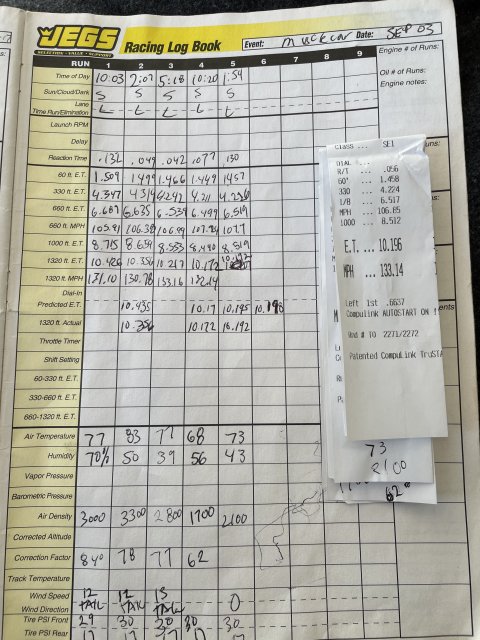

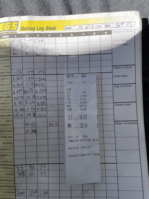

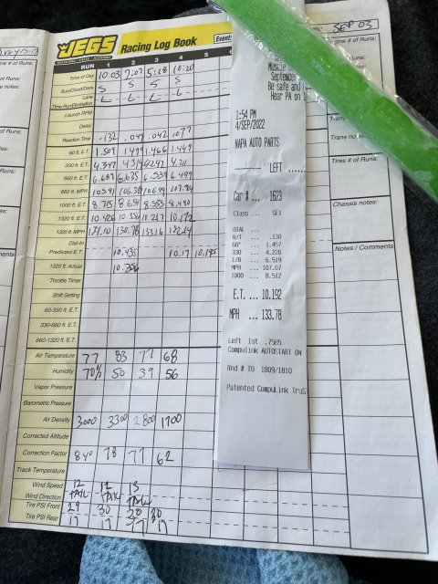

I use hi- tack
They move some first time
Dead hooks
Saturday I predicted my et
Within .003
Before each pass.

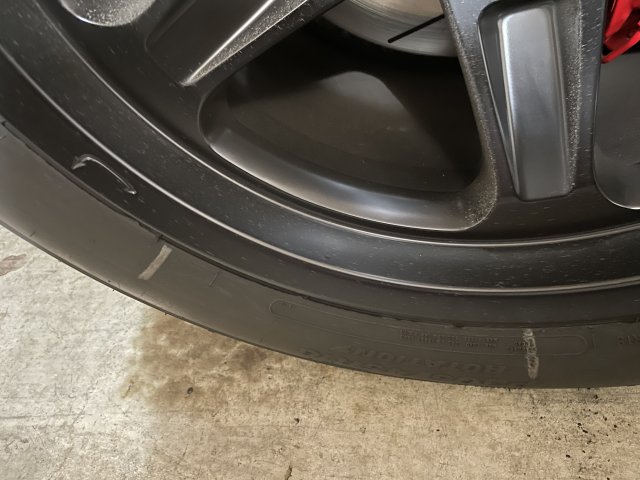

This was after 4 passes with some sticky stuff on my beads after thorough cleaning. I have tried a few things, and they always move and get out of balance at the track.
I run about 18 lbs of air and run high 1.49s-1.57s with these tall tires. My stock tires used to move (the drag radials) but not as much, and I pulled mid 1.4s all day with them.
I now have my own at home tire changer/balancer set up, so I will commit to just rebalancing them after each track day.
ALTHOUGH.... when you make 3-6 passes, car shakes a lot in the upper mph, which is terrible & unNerving. $4k beadlocks & matching fronts are not an option with this Biden admin. :-(

I wonder if just not putting weights on them would help your situation? Mine are balanced and even thought they moved 10 or so inches on the rim I didn't get any vibrations surprisingly.

If you use my system you can fix them (re balance) right on the spot without removing the wheels/tires from the car. I have been doing it for YEARS.

You have 1000hp going through the parts in your transmission. All’s good. Then you start with the impact wrench action from those out of balance rear wheels. That Jack hammer like impact will do exactly what you think it might do… Check the cost of the Weld Laguna Beadlocks. Then check the cost of a new trans.
