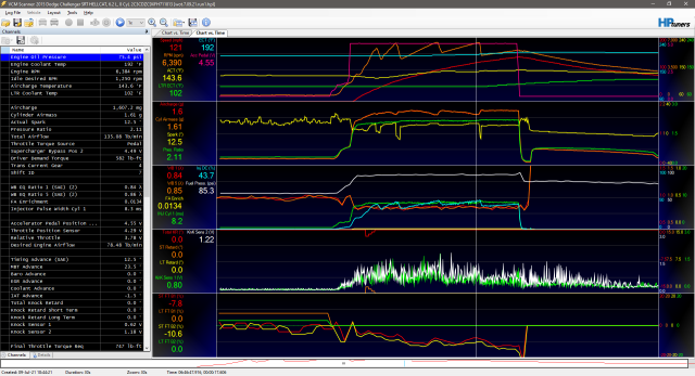

Are most desensitizing knock sensors on these cars? I see a fair amount of STKR on take off with a 2.85 and e85 using stock timing down low. Ramping it in up top I get no STKR. I feel I should be able to add 5 to 7 deg down low without getting any STKR.
I'm thinking I'm going desensitize a little to a little bit in the ranges I am seeing the KR.

In your logs are you seeing LTKR? If so do not desensitize the sensors, you may have a legitimate issue.
4,255
10,587
I have no long term.
I will say the only thing that worries me for future issues is this car in the spring with the originally tuner I had with Diablo he wrote me a 93 tune told me to go wot and the car pulled 14 deg. For that pull. Not good. What really worries me is when that happened to @Speedy! in his video his engine went boom. But that was in March and I have left that tuner and went e85.
It was Legitimate because octane booster took the knock out........ I should have sold the car after that but to late now I'm pretty invested with this one.

I'm not seeing anything that bad. Maybe what I am seeing isn't even bad enough for me to worry about.

Hmm actually glad I just went back and looked at this. That log actually wasn't from a tune I touched at all and was from an e85 tune that I paid for that I reviewed. But looked at the fuel. It went a little lean for a quick second and when it richens back up it slowly goes back to no KR. STFT aren't bad there though which is odd.
Glad I made this thread to catch that. Still a good question to be asked about the sensors. I haven't been back to the track with the tune I've been working on. I have been updating injector data on the street. I'll have to head to the track and make a few runs and see if fuel stays where it is supposed to before I try anything else.

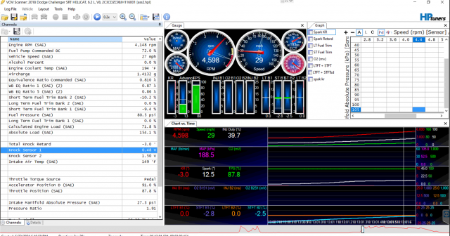

Also with the knock you saw on e85 were you getting smoke out of The exhaust at any point? Or did you have any other symptoms besides knock in the logs?
Also in this log it looks like knock sensor 2 is the one that spiked.
I’m not sure about other logs. But looking at a chart of placement it’d be my guess that would be the one that picked out the most blower noise.
But cylinder 7 is also on that side.
When I experienced knock at the track on gasoline yes puffs of grey smoke when it would do it. Don’t know on corn as I didn’t have a camera to mount back there to look for it. Right now I’m in start up tuning of rebuilt engine and I won’t desensitize the knock sensors or use octane booster in gasoline any longer based on what I saw during tear down. Only real symptom in the logs where knock, my 1/4 MPH hit 142 in cold air negative DA. Something I wondered about is I was condensing alcohol in my UPR catch can when it was in the 30’s back in November, from blow by, I bet that does not happen this year when it gets cold out as now I have little to no blow by. I’ll look for those knock screen shots during lunch break today. Plugs 1, 3, 5, and 7 are easy to get out, I’d look at them all and leak down test while your at it, it’s the only way to really know. You could also borescope the cylinders. BDC and look for missing piston material in the valve relief areas if you don’t have a compressor to do a leak down test but it’s very hard to see and not really conclusive info.
