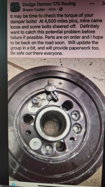

@Speedy! Crank pulley recall for the 170? If only they pinned them..
Well, that's certainly a mistake also, but pinning won't stop the bolts from backing out on the back side of the pulley... someone forgot to use loctite I guess.

Wouldn’t stop it but less chance of damage, if the bolt backs out it’ll spin on the crank

3.5 hrs for the recall on my plugs. The factory original plugs gap was averaging .030 / .032 with no signs of improper combustion. The new plugs checked in @ the recommended .024 right out of the box as would be expected after a recall.
Yep it should have been pinned and set with loctight.

Rumor is a new crank pulley design is being tested. I'd think the 170 crank pulley is the same as all other Hellcats so why the issue?
That is definitely not the same damper as the HC.
My understanding is that it's the new part made by Fluidampr.
The 170 is an actual fluid dampener unlike hellcats and redeyes, or so they say

May have been better with the Hellcat part then lol.
Or tried and true ATI.

fluidamper is supposed to be better for harmonics
Maybe, but apparently only up until it comes apart and grinds up your timing cover. lol.

ATI requires pinning I think? Voids the warranty.
I don't think they require it--just highly recommend it. But they should all be pinned--warranty be damned.

I was more worried about it spinning in the crank I thought that’s why they were talking about. Shouldn’t destroy the engine if those back out now that I see what it looks like. I HATE those screws. TBA uses those on their thermostat clocker. I stripped one. Need to find a higher grade replacement that’s stronger. Horrible

After pinning two cranks and going to new tty bolt I'm much less worried about the crank pulley spinning. These cars have been out for a while now and we're not hearing about that issue since new tty crank bolt.

They should stop all this bs, make cranks with a woodruff key and buy wholesale from ati for dampeners and put it in the DC catalog. Problem solved. Penny pinchers are assholes at stellantis

Pinned the car in the first round of mods and never looked back.
It won't be so much of a concern on the next motor as it won't be driving a blower but it will probably still be keyed or pinned

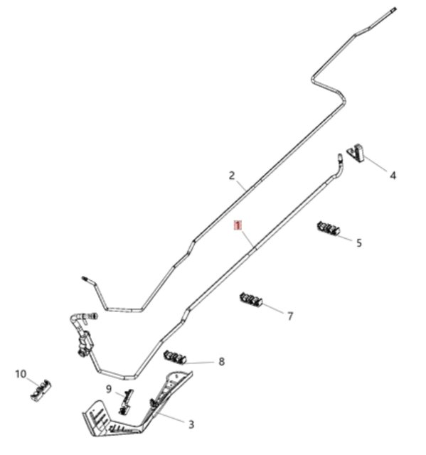

I've looked it over pretty good and other than a "voltage stabilizer" that's in the trunk by the FPDMs, the only other thing I see different is some kind of box the fuel line runs through on the passenger side. At first I thought it was a filter, but it doesn't appear to be serviceable. Someone suggested it's some kind of cooler? I'm also not sure this is unique to the 170, might be on other 2023 models.
Could definitely be a fuel cooler. Cooler fuel = more power. Wonder if anyone found out what it is yet. It also appears to be a thing on all 2023+. Just ordered the redeye/superstock/demon 18-22 main fuel line, and it’s not made for this, but that part says it fits regular hellcats as well 2023+

Expensive little bugger

I ordered this, which “should” not use that, but has the flexible fuel “jumper” to the rail built into the actual hardline
