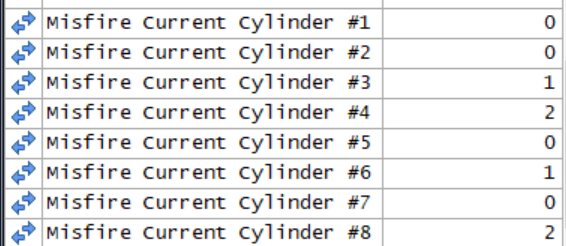

Is that a failure of the plug, or did the car go lean and burn the strap or something?
I think running these cars hard on 91 or even 93 is a bad idea, and I also think going too high in E content is gonna be a problem for the fuel system. It makes full power on E65 and at E67 my logs show the fuel system is "OK". I'll test full E85 just so I know, but there's no reason to run full E85.
Not saying the owner did anything wrong, just calling out some things I've seen that I'm afraid a lot of people don't realize with these cars. I see people with 501 miles hitting the track and dumping in E98.
Manual says no track use until 1500 miles. I'm at about 800 now. Is this "Warloc" from the other forum? He made a comment on a spark plug thread indicating he'd seen an issue with his.

I shared this on the other forum in the D170 spark plug thread. This was after two WOT pulls on E67 4-6 gears. As you can see mine is not seeing any misfire problems which have been reported by some and I'm wondering what's up.....bad fuel, bad plugs, internet rumors, dunno.
3,774
8,928
Those plugs are typical of what happens with too much boost and timing for the fuel octane being fed to the engine. ie what @Speedy was saying he was seeing in logs running 93 with his 170.
Just because the PCM is programmed/tuned to remove timing when it’s seeing knock i.e. detonation, doesn’t mean it’s going to be able to remove enough advance and quick enough to prevent a cylinder meltdown which spark plugs like that are indicative of. I’m sure if he would’ve done a leak down test probably had a blow by issues past the rings as well, and possibly exhaust valve leakage issues from the pieces of spark plug ground strap possibly getting caught in the seat of the valve. That’s sad for a new car :(

6,092
21,627
I believe the manual comments about this Speedy
Full power at E65
It also talks about excessive Ethanol will have a power reducing affect due to the limited capacity of the injectors
I m not sure if that would turn into a miss or a lean situation

lean would turn into a miss after the plug tips where gone, like pictured lol
