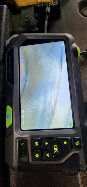

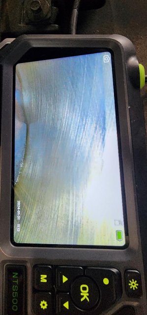

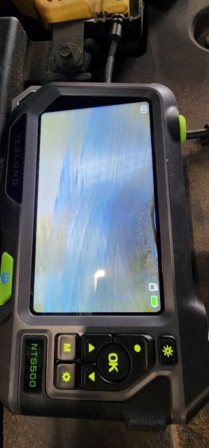

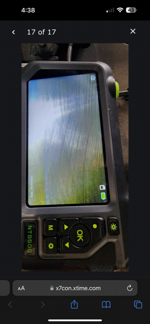

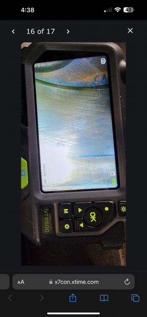

I do some wrenching but I’m not a mechanic by any means should get some more info tomorrow but here are the results from the borescope and compression test.The only thing I noticed was Crank and cam wave pattern was checked no by the tech. I asked for the diagnostic tests to be done for piece of mind since at the time nobody at the dealership seemed to know what actually happened to my car.

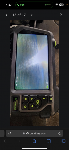

Update 7/1/24
Dealer sent pictures of bore scope and clearly sent pictures of a different car, date on photos is from January 31st of 2024 and engine bay looks nothing like mine. Waiting on blackstone kit to send out sample. Scheduled appointment for a second opinion.
