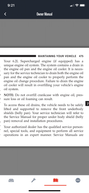

So on every other oil change you'll have 7.5 quarts of oil in it. The oil cooler should be drained every oil change, my .02

It's about 1/3 qtr. in the oil cooler , just saying it will be more than 7 if you don't drain the cooler.

The Owner’s manual says to do a correct oil change the cooler should be drained each time the oil is changed . It makes no since in my mind to not drain the cooler each time . But to each his own . 86031BAD-5D57-4B42-ADE9-366978F5E36E.png

Don't kill me for asking this but I must ask. Most guys who complain about draining the oil cooler is removal if the access panels. They are a pain in the ass to say the least. What would be the harm of taking them off and leaving them off? Cars never used to have them. Seriously, when is the last time an object bounced up and busted up your oil pan? Yes you will be less aerodynamic. Instead of going 203 mph you will go 201. Just sayin...

That plastic is barely enough to keep a large bumble bee away from the pan. It's not a skid plate by any means.
Personally I wouldn't want to try 200 mph without that plastic, though. Chances are that the front end could get light.
Either way, it was very easy to install James access panel and not have to remove the front portion again to drain the cooler.

Get this to solve that issue https://oilcooleraccess.com/

I just cut a hole in panel right where the oil cooler drain plug is , so I don't have to remove that panel , I just remove the panel for the oil filter & pan plug , 4 bolts that it much easier .

^^^^ Just make sure the cut out is just big enough to get channel locks or crescent wrench on it to hold as back up on that drain line as you break lose & tightening the plug , you don't want to bend or break the drain line tube !

I use a regular wrench, which also works quite well.

Yeah , what ever works for ya , point was to use a back up , happy motoring !
