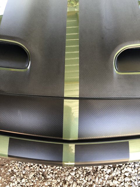

They definitely look good
Breaks up the paint nicely
If you look close at the stripes on the front Fascia / Bumper
They may be 2 pieces ( 4 total )
Mine are

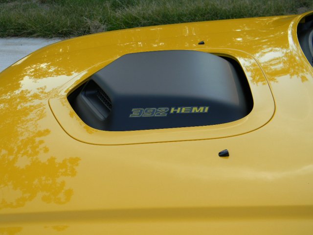

When I put the shaker on my Yellow Jacket. I did the the shaker in a satin, and cleared it with a satin clear coat, to avoid all that aggravation. It turned out perfect. 010.JPG
5,764
20,384
Looks good !!!
The shaker always looks bad ass

I would add that I was the the first to put the shaker package on the 392. I did it before Dodge did.

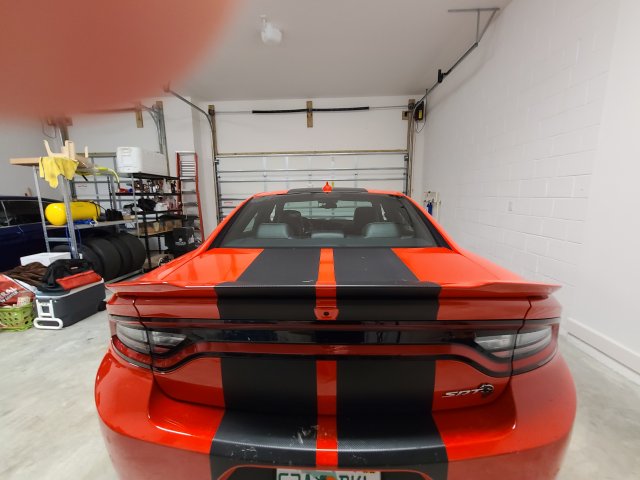

Just had my guy do them again. They were full of wax when I first got the car, dealer detail guy must of smeared wax all over them. Clay bar was the only thing that would clean them up. I them sprayed Reload on them and they've looked great since.
Sent from my motorola one 5G UW using Tapatalk
191,499
Still looking good and the car is filthy here.
