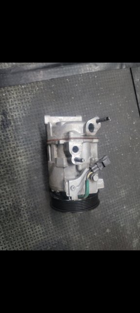

Fresh compressor in the AM. We shall see.
Frash presser, large $$ end 1st but save time wit da rest. Have youz testacal da delter t in er yet? Youz bee lukin fer 17 whore bettah. Dat wood sayve alot of time wit da cumprasser. Dat wood tell alot. Slut engagen mint, all waz luved dat at Diamund Dulls, slut engagement, hate engagements wit no moe, refrig lines cum taminateded, whore cunt controlls, hate dat. Wishet I wuz dare 2 help.
