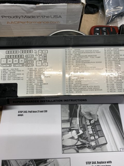

I'm in the process of installing a BAP and noticed on page 117 it says to remove fuse 21... fuse 21 on my PDC is a SPARE. Looking at the list the Fuel Pump is 26 and is a 30A. Should this be the one I pull and replace with a 40A?

So the circle jerk begins... Call HHP, tech is gone... Call Kenne Belle, tech is gone... hey call Barth though as they buy a lot of our products. Call Barth, unavailable... gonna have to figure this out. Might rewire the PDC... I've had dumber ideas.

I can’t tell from the pic, but are you in the trunk fuse block or the under hood one? You need to be in the trunk.
What year car?
Edit - looks like the trunk box from what I can recall. Also, looking online it appears that 21 or 26 can be for fuel pump.
3,968
9,810
I am in the PDC in the trunk. Car is a 2015 Hellcat Challenger.
4,263
8,811
So check out this picture.
LX = older Challenger.
LD = Charger
LA = newer Challenger.
I imagine your instructions are either “universal” and therefore universally wrong, or they’re for a different car - the Charger.
I’m sure someone will have info for you in the morning, but if you’re trying to get it done tonight, I’d bet on 26.
Attached another pic, this is the fuse block in my old 2016 Charger. Compare it to yours and see if thats the case (See if they’re different). Sorry it’s a crappy pic, I snagged it from my trailer hitch video, lol.

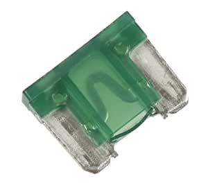

Thank you for the information, yeah fuse 26 is probably it but it's a low profile bussmann style like this:
They sent a maxi style fuse like this:
I'm gonna reach out to HHP and see what they recommend. I'm not blowing my fuel pump up, that's for sure!

instructions are for the hellcat (chally?)
fuse box looks similar, but 21 is a spare for me
3,968
9,810
Juat noticed the instructions are for a whole KB s/c kit... whack. Will reach out to HHP. Its getting late. Thank you for your help @Jack_Toepfer much appreciated!
